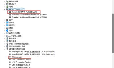

          Although not recognized on the PC side, this may be related to the JLink driver, you can try to update the driver. Can you download the program successfully through the IDE using JLINK?
          From the point of view of the steps, there is no problem with burning firmware. You can attach a few pictures of the problem if it is convenient. This is the state of my device manager as shown below:

If the JLINK Firmware is flashed to the board, The microcontroller is not recognized as JLINK device in the device-manager. If CMSIS is flashed, I see the LPC LinkII
