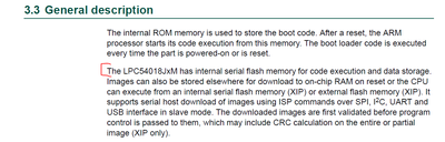

ahmed_mostafa
@Alice_YangThe part number we are using is LPC54018J2MET180. According to the datasheet and the manual, this part does have internal flash memory for code execution. Using SWD and using MCUXpresso, how can we load our code into the internal flash memory?

Hello ahmed_mostafa,
1) Yes, the chip of LPC54018J2MET180 have internal flash.
2) You can download a SDK demo to test.
3) How about use another debugger? J-link or LPC-link2 .
Alice

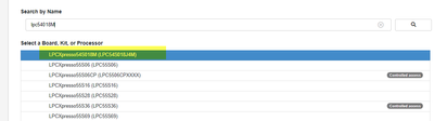

@Alice_YangWhich SDK demo should I use to test? All of the SDK demos use external flash. The LPC54018 IoT board that I am using uses an external flash memory for storing the program. How do I tell the microcontroller to store the program in internal flash instead?
As your chip is  LPC54018J2MET180, please use the SDK
The part number without "M" meaning the chip doesn't include internal FLASH.
Alice

When I try to load the code into flash memory, I get this error:
Driver V.2 dynamic startup failed - driver Init provided no flash parameters
Flash Driver V.2 startup failed - rc Ef(55): Dynamic flash driver startup failed to provide flash parameters.
Terminate (0x0, 0x0, 0x0) status 0x40 - driver reports init failure - EXTSPI driver rc 1 - Device is busy
chip initialization failed - Ef(55): Dynamic flash driver startup failed to provide flash parameters.
failed to initialize flash driver LPC540xx_SPIFI_SFDP.cfx
I suspect that the flash driver built into MCUXpresso for this specific part does not know how to communicate with the internal flash.
For this particular part, there are 2 variations. There's the LPC540xx which do NOT have internal flash storage. Then there's the LPC540xxJ, which DO have internal flash. I suspect that the "LPC540xx_SPIFI_SFDP.cfx" driver that is used in the IDE is not compatible with the LPC540xxJ variant of the part.
@Alice_Yang @converse any help?
