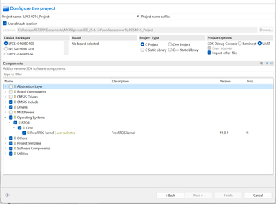

Thanks for the response. I have the SDK downloaded manually, every setting is default and I am using the FreeRTOS kernel files from it, but I am running into a specific runtime issue during the scheduler startup.

My setup:
Probe: MCU-LINK (r0FB) CMSIS-DAP V3.165
Linkserver Launch commands : LinkServer gdbserver LPC54016 --allow-remote --keep-alive
MCU: LPC54016JBD100

I think although you are using the same probe (MCU-LINK CMSIS-DAP), the initialization script for the GDB server is different. The CPU startup status may be completely different.
Harry
