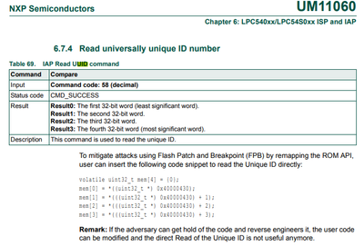

Trying to read the unique ID from a LPC54016 using the IAP function IAP_ReadUniqueID and I just get zeros.
User manual suggests also reading direct from address 0x40000430 which again produces all zeros.
Any ideas?

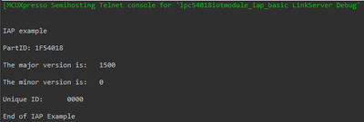

I'm trying to use the IAP mode registry to look up the serial number (UUID) of my LPC54018 and no matter how I try, I only read ALL zero.
Trying with the example of the IAP utility (lpc54018iotmodule_iap_basic) SDK 2.9. I read When you see in the picture.nxp_iap_bug.PNG
We also try with the way is describe in the datasheet (SEE PICTURE) but no succes.

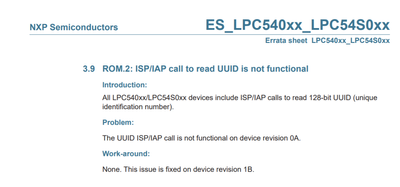

Ok, I know why.. This is a Factory error on the device revision 0A (see the Errata sheet LPC540xx..)
https://www.nxp.com/docs/en/errata/ES_LPC540XX_LPC54S0XX.pdf

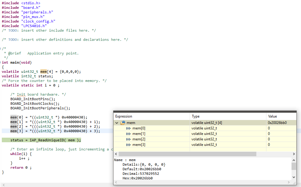

I've created a new project from the template, with just the code to read the ID, similar to yours. Trying both the direct read from the address in the user manual and the IAP function.
Both return all 0's

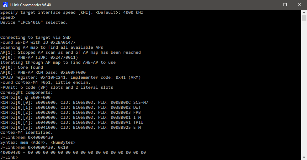

Also manually reading via J-Link Commander ..
If it helps to ID the silicon revision, calls to the functions below return the following values
IAP_ReadPartID = 0x1f54016
IAP_ReadBootCodeVersion = 0x1500

Yes tried that, all zero as per the memory view of those locations.
Carl
