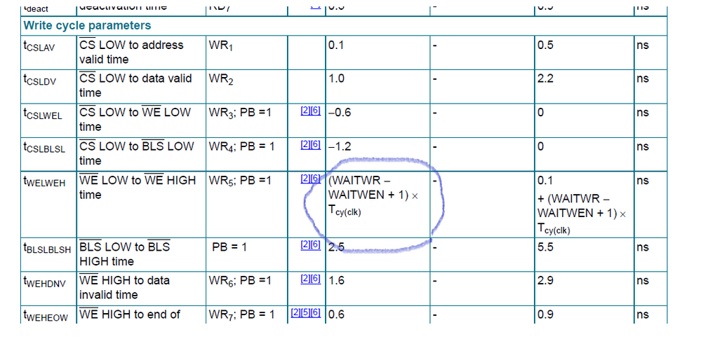

vasyapupkin
Hi!
Thanks for the answer.
I looked at the timing chart in the datasheets.
It was necessary to set the PB bit in the STATICCONFIG0 register.
Under the description of the register in the UserManual (UM11060) it was not clear)))

vasyapupkin
Hi!
I also do not understand)
But this is exactly the case. Setting the PB bit activates the WE signal.
2,256 Views
