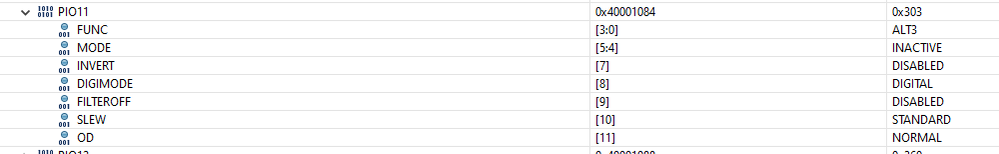

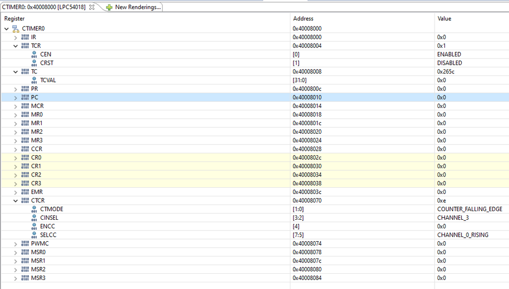

On my custom LPC54005 board, I am trying to use CTimer0 as a counter with PIO1_1 as the clock input.
(CT0_CAP3 — Capture 3 input to Timer 0). I have a 1Hz square wave connected to the pin. This signal is clean and recognized by the MCU. When using the interrupt as we do for counting slow signals, I see an exact count so I think the hardware is OK. When I try using the hardware CTIMER0 as a counter for higher frequency signals, retrieving the TC every minute and then immediately clearing the count, I get extremely large TC values ~ TC:10269 that are also not stable. I also tried reading the TC and using the difference from the last reading with same problem.
 It looks like the timer is not routing PIO1_1 as its clock. I just want to use CTIMER0 as a hardware counter.
I added the FSL_FEATURE_CTIMER_HAS_CCR_CAP3=1 in my Symbols.
In the debugger using MCUXpresso I can not read the TC value but other registers are available:
I also attached my code snippets that initialize CTIMER0 and read it periodically.

Please modify CTIMER_GetDefaultConfig to enable the Ctimer to be clocked by the CAP input, just like the below shows.
void CTIMER_GetDefaultConfig(ctimer_config_t *config)
    assert(config);
    /* Initializes the configure structure to zero. */
    memset(config, 0, sizeof(*config));
    /* Run as a timer */
    config->mode =  kCTIMER_IncreaseOnRiseEdge;
    /* This field is ignored when mode is timer */
    config->input = kCTIMER_Capture_3;
    /* Timer counter is incremented on every APB bus clock */
    config->prescale = 0;
Note that, you also need to configure the CAP input pin the BOARD_InitPins() function.
