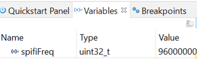

The default SPIFI clock speed is 24MHz. I can use below code to change SPIFI clock to 96MHz without issue
Here SPIFI clock source is FRO96, clock divider is 1. In debugger we can see SPIFI clock speed 96MHz
