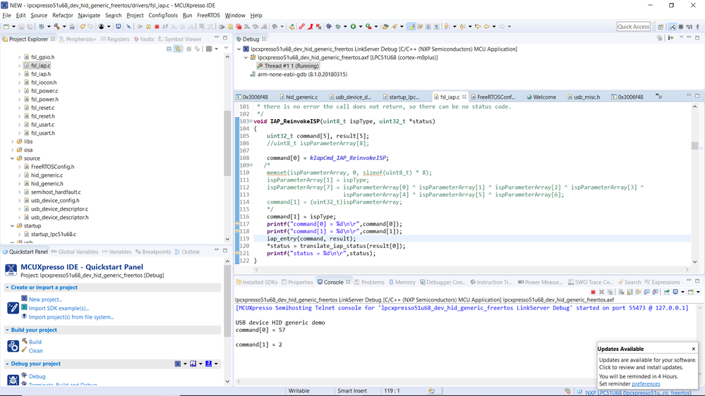

seowwoo_quek
Hi Alexis,
I made the printf but I am making use of fsi_iap.c - IAP_ReinvokeISP API. The function iap_entry(command, result)never return to
*status = translate_iap_status(result[0]);
Thanks.

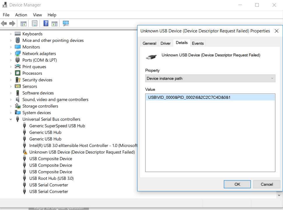

seowwoo_quek
9,888 Views

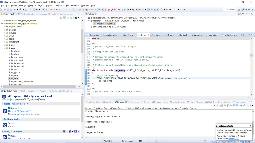

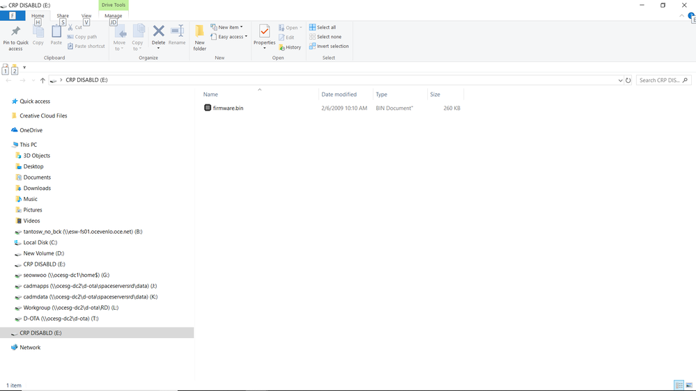

seowwoo_quek
Hi Alexis,
when I used the iap_flash example. the IAP_ReinvokeISP API works but I need to comment out the
//__disable_irq();
But I need to use the dev_hid_generic_freertos example to enter IAP_ReinvokeISP API . looks like need to do other setting for USB HIB before calling IAP_ReinvokeISP. Can help to find out why?

Alexis_A
Hi Seow,
The USB API's are in ROM and I suspect the transfer data from the host could cause problems while changing to ISP mode cause this mode also initialize the USB module.
Could you try disabling the USB module before Reinvoke ISP function?

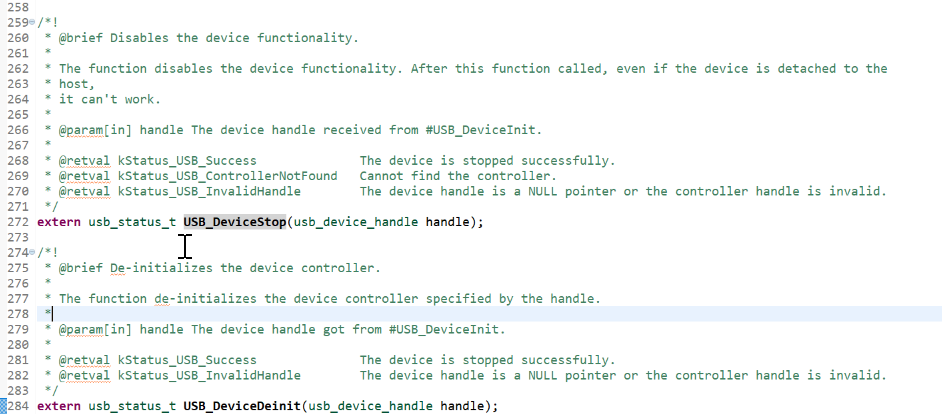

Alexis_A
Hi Seow,
Please take a look to this functions:
Alexis Andalon

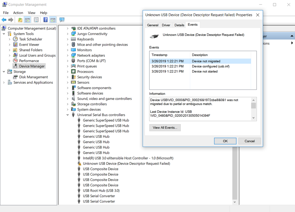

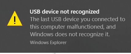

seowwoo_quek
Hi Alexis,
i tried all of these functions
USB_DeviceDeinit(g_UsbDeviceHidGeneric.deviceHandle);
 USB_DeviceStop(g_UsbDeviceHidGeneric.deviceHandle);
NVIC_DisableIRQ(USB0_IRQn);
before I call
IAP_ReinvokeISP(2, &status);
The result is the same, I cannot go into USB MSC boot mode. and USB not recognized
what is the USB PID and VIP for the USB MSC boot mode?
