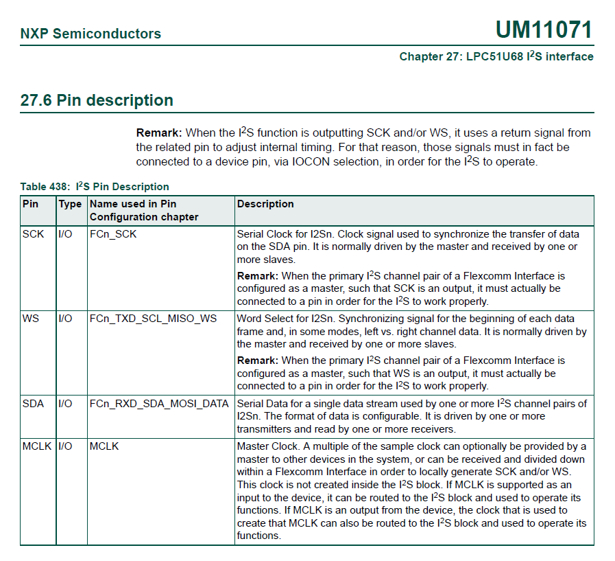

Hi, I am using LPC51U68 on which I would like to implement TDM transmit function.
I need 4 slots within a frame.
However, LPC51U68 has only one channel pair within a Flexcomm interface.
Therefore, I'm assuming I need to use two Flexcomm interfaces in order to implement 4 slots TDM transmit function.
In this case, is it correct to directly wire Flexcomm 6 SDA pin and Flexcomm 7 SDA pin outside the MCU in order to form single SDA line?

Hello @Kodai
Thanks for your question.
Yes, your understanding is generally correct. You can Directly connecting the SDA pins of two Flexcomm interfaces.

Kodai
Hi, @Alice_Yang .
Thank you for your reply. I'd like to ask you another question.
Does that mean when Flexcomm 6 is sending the data and Flexcomm 7 is not, the SDA pin of Flexcomm 7 is automatically set to high impedance?

Hello @Kodai
I believe the answer is yes, but I haven’t found explicit confirmation in the User Manual yet. I’ll help you create a private ticket and verify this internally. Once I receive an update, I’ll reply to you directly on the  new ticket.
