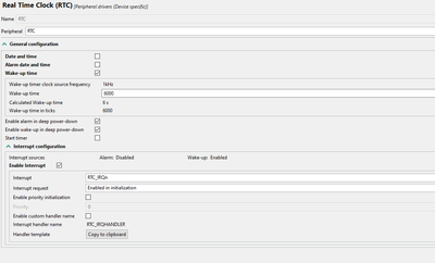

Hello all,
I try to wake up DPD from RTC wake up timer or RTC Alarm. All my test seems not working.
Have you an example with RTC wake up please?
1 :  I inspire from SDK example (but it with button)
2 : I configure with peripheral like this
NB : the timer is enable by software after initialize alarm and time.
3: I try adding the few code below :
 SYSCON_RTCOSCCTRL_EN(1);
  SYSCON_STARTER_RTC(1);
  RTC_EnableWakeUpTimerInterruptFromDPD(RTC,1);
  RTC_EnableAlarmTimerInterruptFromDPD(RTC,1);
I call like this :
      RTC_SetWakeupCount(RTC_PERIPHERAL, RTC_WAKE_UP_TIME);
      POWER_EnterDeepPowerDown(0);
      // or like this
      //POWER_EnterDeepPowerDown(SYSCON_PDRUNCFG_PDEN_SRAMX_MASK | SYSCON_PDRUNCFG_PDEN_SRAM0_MASK);
4 : I understand that Wakeupcount is onetime use.that why I reinit it before enter DPD
5 : the RTC_IRQHAndler work with wakeup or alarm before I call EnterDeepPowerDown.
thanks for help.

Benoit2
Hello XiangJun Rong,
thanks for helping.
The problem was hardware. I don't know why.
for informations :
my last settings are :
and to go to DPD:
RTC_SetWakeupCount(RTC, 6000);
I don't need to do this :
SYSCON->STARTERSET[0] |= SYSCON_STARTER_RTC_MASK;
according datasheet "Deep power-down mode has no configuration options"
Many thanks for help.
kind regards,
Benoit
