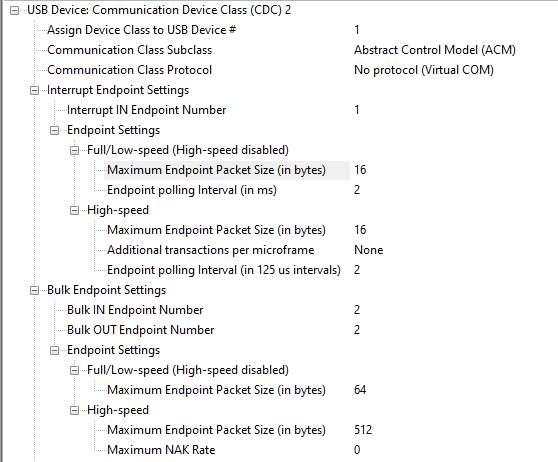

Sabarish
Hi @Alice_Yang
        I have already configured CLK_USB1 to generate the clock for USB1 interface for 60MHZ. I have Configured USB1 as device(Full Speed mode) and connected to the PC. In LPC43S57 USB controller I can able to see the USB is attached as A device in USB Status register but in PC I can't able to see any COM port or any other USB device is connected. I Have Configured USB0 as device and connected to PC it is detected as COM port and not working with USB1 configuration.
I have attached  USB1 device configuration image for your reference
