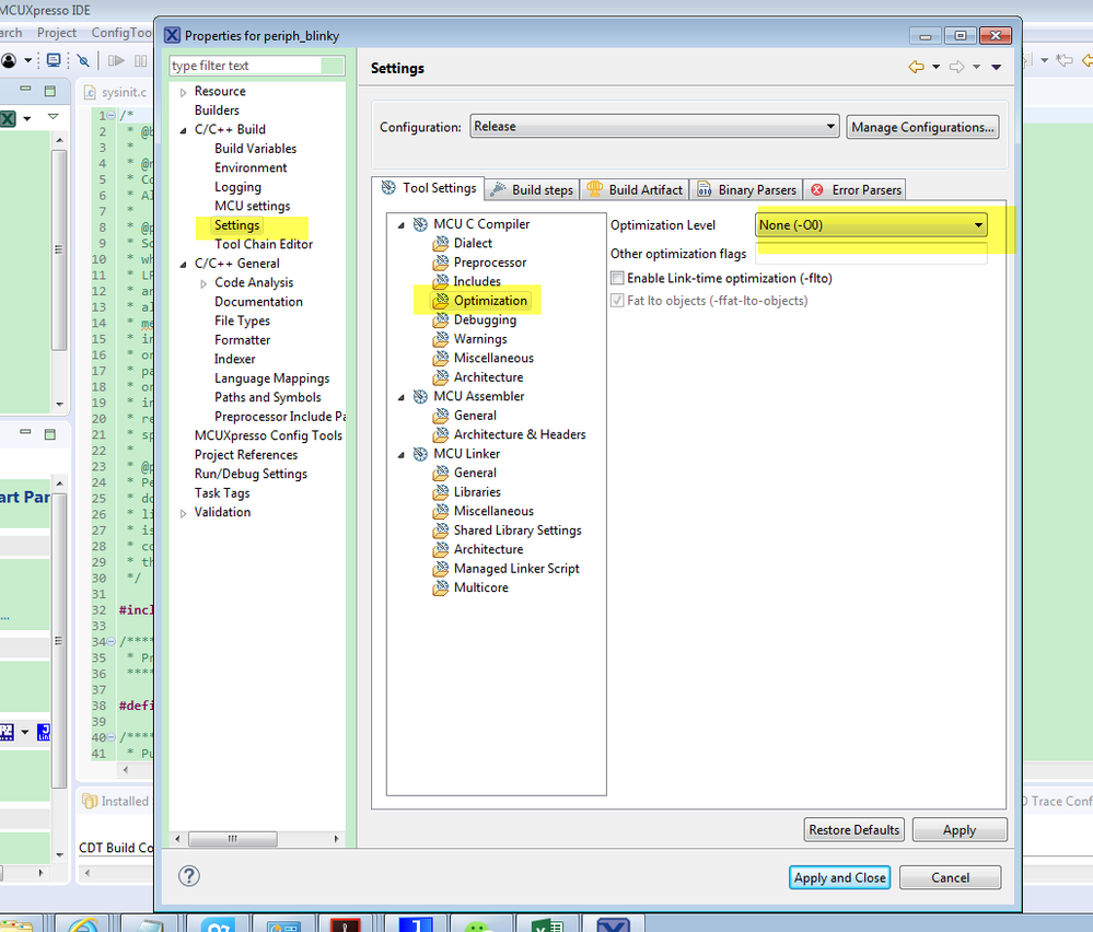

LPC43S57 enters in deep sleep mode, but when I toggle the wakeup0 pin, the software do not wake up ! (I have checked the HW signal and it move correctly from 0 to 1, or even from 1 to 0 but without effect)
Something strange is that the wake up occurs correctly if I load the "debug" version of my software (same code, but with configuration "debug" in MCUXpresso)
I also test a really similar software on the MCB4300 evaluation board (LPC4357 instead of LPC43S57), and the wake up occurs correctly in both "debug" and "release" configuration.
Do anyone have a clue about my problem ?
Julien

In many cases, when issues are seen where code works built for Debug but not Release, the issue is a missing "volatile".
I suggest that you take a look at the following FAQ for more details : Compiler Optimization

Hi Julien brissard,
  Please try to select the optimization level to None in the release mode, then build the project, and try it again:
