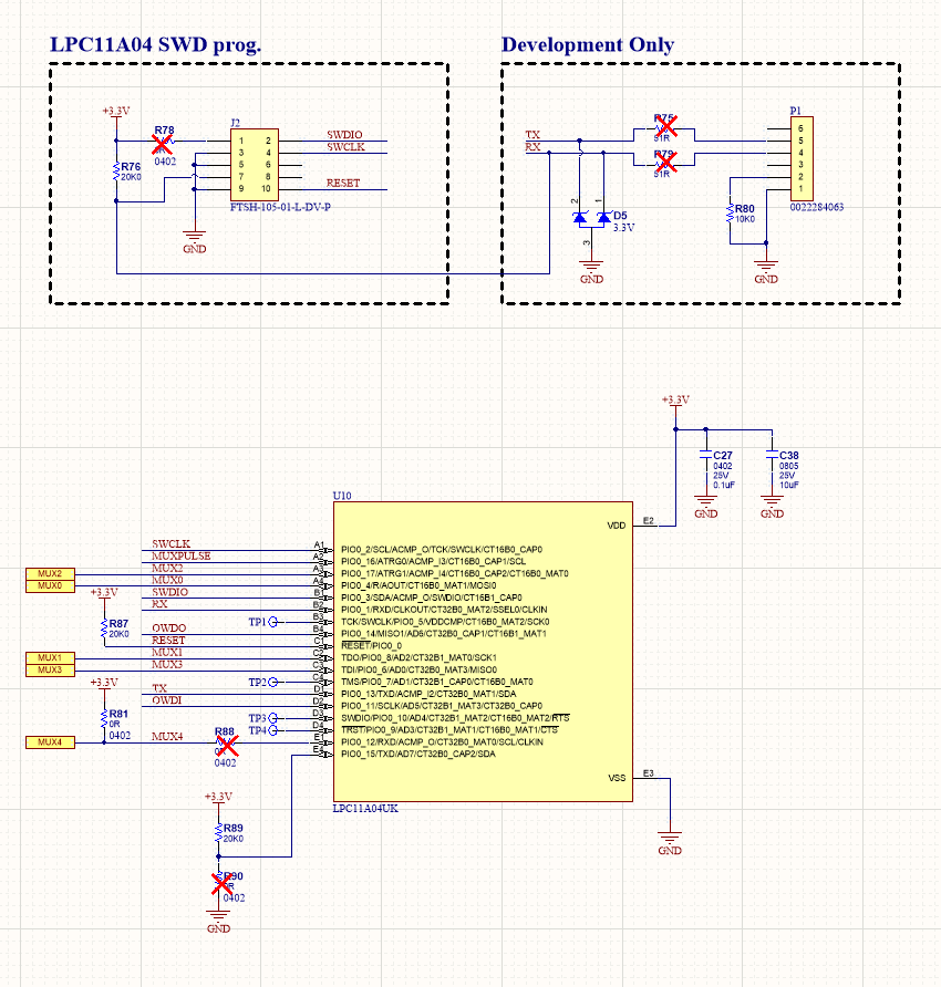

Here is my schematics around LPC11A04UK.
His footprint looks good to me and the power supply of 3.3V is OK.
Also, I tried the secondary SWD port (PIO0_5 and PIO0_10) : it won't work.

jeremyzhou
Hi Louis-Philippe Dion ,
Thanks for your reply.
Recommend: It must ensure the JP2 be closed if you want to use the LPC-link2 as the debugger.
In further, you can refer to the schematic of MCB1000 to correct your own one, please checking it.

Yes, JP2 is closed. Also note that the pull-ups on SWDIO and SWCLK that i added are not shown on my SCH.
About what you proposed, the MCB1000 do not use the same MCU as our. Our problem is really with the LPC11A04 since we have been able to connect with the LPC11U24 (with a different program of course).
The only difference i see in our PCB is the absence of an external crystal, but the chip is suppose to be running on IRC, see the following directive from the datasheet :
« Following reset, the LPC11Axx will operate from the IRC until switched by software. This allows systems to operate without any external crystal and the bootloader code to operate at a known frequency. » [p.34 of LTC11A04 datasheet)
I'm sure our RESET is OK since i have a different error message if i don't reset the chip (or if i don't pull ISP LOW), which is «Target marked as not debuggable». It looks normal to receive such an error since we need the RESET to use PIO0_2 and PIO0_3 for SWD. If my circuit was not OK, i think i would still get that error message...Now, the message i get is really the one i said in my first message, which is « Could not connect to core »

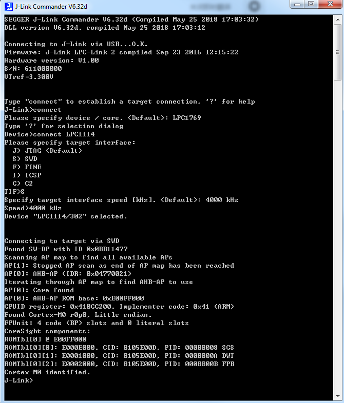

To validate the hardware circuit, I'd like to suggest you follow these below steps to connect the LPC11A04.
  • Updating the LPC-link2 with J-Link firmware.
  • Open the J-Link Commander to connect the chip.

I've updated the LPC-Link-2 with J-Link firmware and i tried to connect to LPC11A04 using the J-Link commander like you suggested and it still failed to connect...
From the SCH i gave you, have you seen any bad connections (except for the pull-ups on SWDIO and SWCLK that i later added) ?
Could you confirm that we don't need an external crystal on our PCB ?
Have you heard of similar problems with the LPC11A04UK (WLCSP20 package) ?
Is there anything else i can try ?

1) From the SCH i gave you, have you seen any bad connections (except for the pull-ups on SWDIO and SWCLK that i later added) ?
-- No, however, the issue definitely is related to hardware circuit according to your testing, I think you'd better check the PCB carefully.
2) Could you confirm that we don't need an external crystal on our PCB ?
-- The LPC11Axx can work with internal crystal, the external crystal is not necessary.
3) Have you heard of similar problems with the LPC11A04UK (WLCSP20 package) ?
-- No.
