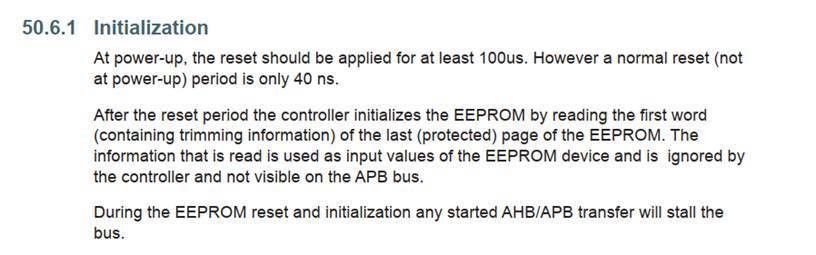

Hi Everyone,
I have a customer using the LPC43S37JET100 that has a problem with internal E2prom.
After Power-on sometimes it is not possible to read the e2prom - the reading value is always 0.
See below the calls related - BSP is LPCOpen 3.02 for LPC43S37.
In the manual a time is specified for e2prom reset:
This time is not included in the SW - if the customer is adding a delay the function seems to work fine.
The customer wants to know if we can confirm this is the issue and no others.
Stefano

Hi, Stefano,
I think it is the reason to read incorrect EEPROM data. After power-up, you have to delay some time until the EEPROM initialization is over, then read EEPROM.
Hope it can help you

Hi xiangjun.rong ,
In fact, adding a delay, it seems the issue disappears.
The customer wants to have the confirmation this is the issue and not others.
In our SW seems the delay is not inserted.
Stefano

Hi,  Stefano,
I think it is the issue. The EEPROM has to be initialized before user can read/write, in other words, user can read/write EEPROM only after the EEPROM initialization is over.
