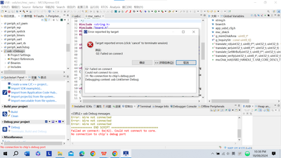

I 'v already finished Configure LPC4370 in USB device mode, which is :
Completed the basic USB stack configuration and descriptor settings; and set it to Mass Storage Class (MSC). In this way, as then LPC4370 will be recognized as a storage device.
The above part is compiled without any errors.
But once I tried to import the compiled project into the LPC-link 2 board connected to the computer, this error kept appearing:
Unable to connect wire for probe index 1.
Error: Wire Ack Fault - target connected?
This error prevented me from importing the compiled code into the LPC4370 board, preventing me from proceeding to the next step.
Could someone help me,thankyou!
2,869 Views
Hello @chenghaoliu
If LPC4370 on LPC-link2 is your target chip, you need another debugger debug. For example connect another LPC-link2 or J-link.

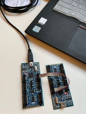

chenghaoliu
hi
I'v connected with two board now,the right one is the issue board, it's always flashing one it powered. I opened a existing test project, just configured the project no additional code with it. it showa it can't find any probes when i try to debug it.
chenghao
2,800 Views
Hello @chenghaoliu
Of the two boards, the left one is debugger, the right one is target board.
There is connection issue with your boards. Please connect as below:
