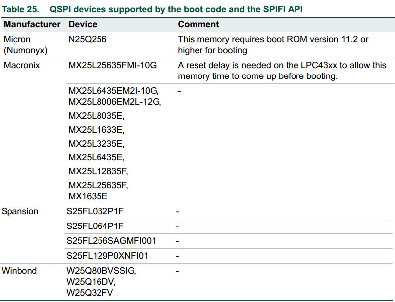

I'm curious what's different about the SPIFI besides the part number?  I doublechecked every pin several times, so I'm 99% sure I have the schematic correct.  The only difference I'm aware of is the part number, which turns out to be fatal because none of the stock .cfx drivers will write to that flash, as it has a type/size of 0x6014 instead of the 0x4014 of the Winbond chip.  I've ordered some W25Q80DV chips to swap in and see if that solves the issue.
As far as the startup issue goes, I am literally creating an empty project.  M4 standalone, don't add the flash region, compile and run.  I'm doing it with the LPC-Link2 providing power over the JTAG cable, but get identical results when powering the board directly from a bench supply.
At this point I have worked around the issue by inserting a delay {for (volatile int i=0;i<100000;i++) ;} around the sysinint.c:97 call to Chip_Clock_SetupMainPLLHz().  This is *not* a viable long-term fix because it results in a noticeable boot delay, but is good enough for now, and ironically is approximate offset by the speed gain of not writing flash...

jeremyzhou
Hi Erik Walthinsen,
Thanks for your reply.
The Table 25 has exemplified the supported QSPI flash devices, otherwise MCU fail to boot from any unsupported devices.
