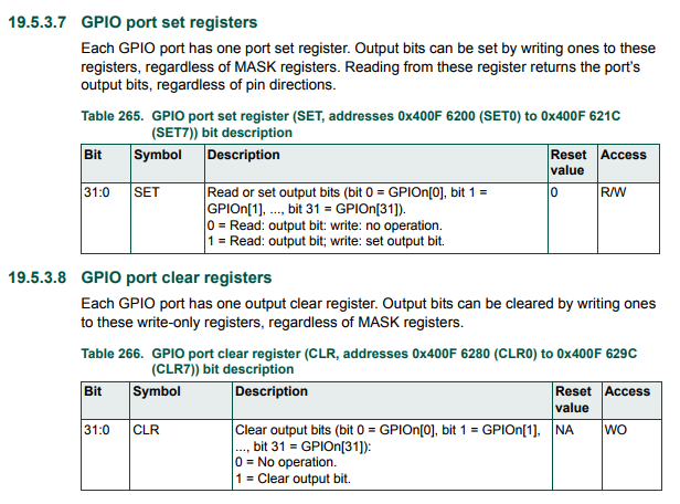

Hello, I am using LPC4367 controller. I need to read and write data on port E and Port F. I know that through set and clear register i can write data on port 0-8. But this SET/CLEAR register is not available for PORT A to Port F. Please let me know how to write data on port E/F. I have configure portpins of these port as GPIO through PIN register. Sorry to ask this much basic question but i am not able to find this information in user manual

According with the user manual you can use the GPIOport set or clear registers for GPIOn[0] to GPIOn[31]
and (n = 0 to 7) .

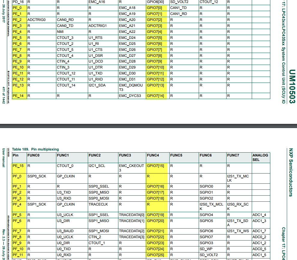

PE_0 corresponds to GPIO7[0],  PF_11 corresponds to GPIO7[25].
