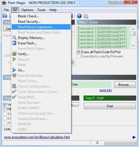

jeremyzhou
Hi mike phan,
Flash Magic tool is able to read out the Boot ROM version when connecting the LPC4357 which is forced to enter ISP mode.
You can learn how to do it via the following link.
https://learn.adafruit.com/getting-started-with-the-lpc810/programming-the-lpc810-with-flash-magic
