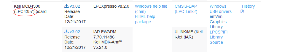

And there is a demo code about Watchdog under LPCOpen, you can download it and have a look:
LPCOpen Software for LPC43XX|NXP
