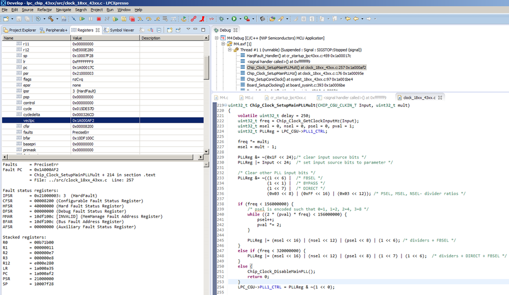

I found out that my LPC4357 based device (which uses LPCopen 2.12 and no OS) sometimes ends-up in hard fault after reset. Once it runs, it runs fine and does not crash.
The reset is requested by an external device via communication. Communication is handled by the M0 core which resets the whole MCU using Chip_RGU_TriggerReset(RGU_CORE_RST)
It takes randomly from several to hundreds of restarts to replicate the issue.
The M4 core ends up in hard fault. The problem happens during setting of clock.
When I repeatedly reset from the user application and connect through JTAG after the crash, I can't get any relevant information from the VECTPC register. If I reset it through the LPCXpresso "Restart" button in an active debug session over JTAG, it shows where the hard fault handler was called.
For this reason I used the restart from LPCXpresso, although I am not 100% sure the behavior is identical.

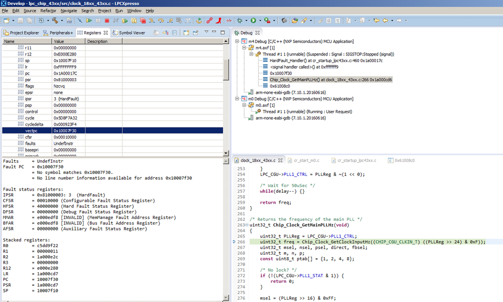

At the beginning I traced it to the call of Chip_Clock_SetupMainPLLMult():
I thought that the PLL needed more time to stabilize, so I increased the delay.
It actually helped, but eventually it crashed again.
This time it was in the call of Chip_Clock_GetMainPLLHz()
I normally debug at the code level and do not have experience at the instruction level.
Does anybody have any idea how to solve this problem?

First I notice that your hardfault in your first image is in the line 257 of that function. Can you provide the whole section of the Chip_Clock_SetupMainPLLMult to see what occurs in that line. In addition can you confirm if it shows this same line in a different instance if you decrease the delay to how it was originally. If not, please provide the line where it stops.
Next you mention that after increasing the delay it seemed to improve but now stops at the Chip_Clock_GetMainPLLHz. Can you confirm if with the delay you had increased, it consistently stops here.
As you mention, it seems to have something to do with the clock. Can you try the following and report the results:

When I reset from within the application by calling Chip_RGU_TriggerReset(RGU_CORE_RST) and connect to the MCU after it stops resetting itself, it is sometimes in the NMI_Handler() and sometimes in the HardFault_Handler().
In this situation I do not see where the handler was called.
When I reset using the GUI restart button (repeated clicking using a click script tool), it consistently happens on the line 257 of clock_18xx_43xx.c

When I change the value of delay from 250 to 1000 it starts to happen (less frequently) at a call of
Chip_Clock_GetClockInputHz()
which is called within Chip_Clock_SetupMainPLLMult() and Chip_Clock_SetupMainPLLHz().
It can happen in either of these.
I assume that if I did not change the delay, it could still happen at the call of Chip_Clock_GetClockInputHz(). It is just more probable that it happens on line 257, so it happens there first.
I do not really understand why the debugger shows that the problem happens during the delay countdown. I would expect that it should happen after the delay decrements to 0 and the following instruction is processed.

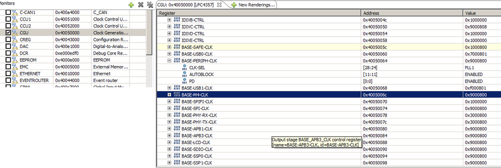

  3. I tried switching the clock source of the M4 and M0 cores from PLL1 to the IRC using:
    LPC_CGU->BASE_CLK[CLK_BASE_MX] = CLKIN_IRC;
    LPC_CGU->BASE_CLK[CLK_BASE_PERIPH] = CLKIN_IRC;
    executed by the M0.
    (The user guide describes the steps for switching of the clock source to high frequency PLL1. If I understand it right, switching back to IRC should be simple, no waiting for a lock, no clock dividers)
    Unfortunately when I stop the controller after executing that and look into the CGU registers, the core and peripherial clocks are still set to PLL1.
    When I change all the BASE-XXX-CLK which have PLL1 in them to IRC through LPCXpresso while the MCU is on breakpoint, the MCU crashes when I restart it and I loose the JTAG connection.

The main clock source after restart is the 12 MHz IRC.
The function Chip_SetupCoreClock() [lpc_chip_43xx\sysinit_18xx_43xx.c] first sets the PLL1 to 108 MHz and then configures the PLL1 as the main clock source.
In the next step it bumps its frequency up to 204 MHz by changing the clock multiplier from 9 to 17.
And this was the part of the code where it crashed.
I tried setting a lower frequency (180 MHz) and it stopped crashing.
I could not give up on the frequency so I tried setting it to an intermediary value of 180 MHz, and after that and some delay up to the full 204 MHz.
Long story short, it worked.
I assume that what Bernhard wrote about the internal voltage regulators could be a key to the problem. The sudden increase of energy consumption after the increase of frequency could perhaps occasionally cause the crash if the regulators would not react fast enough. Unfortunately I haven't found any way to control them. The power management only supports putting the core to deep sleep, power-down etc.
I consider the problem solved by this workaround, but not fully explained.
For higher optimization levels I had to replace the delay loop in the Chip_Clock_SetupMainPLLMult() function.
As @Bernhard Fink explained, the
while(delay--) {}‍‍‍
loop is not guaranteed by higher optimization levels. I had to replace it with his:
for (int d = 0; d < delay; d++){
  __NOP();    // that's for ARM CC, this can't be optimized away
  __NOP();
