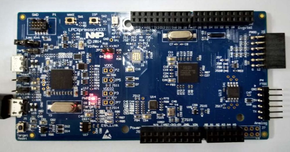

jeremyzhou
Hi Mallikarjun,,
Sorry for the late reply.
I've already ran the LPC4337_multiple_flash example code on the LPCXpreeso4337 (Fig 1), and it works wells without replicating your issue (Fig 2).
So I think the demo is good and  I'd highly recommend you to check the hardware again.
Fig 1
Fig 2
Ping
