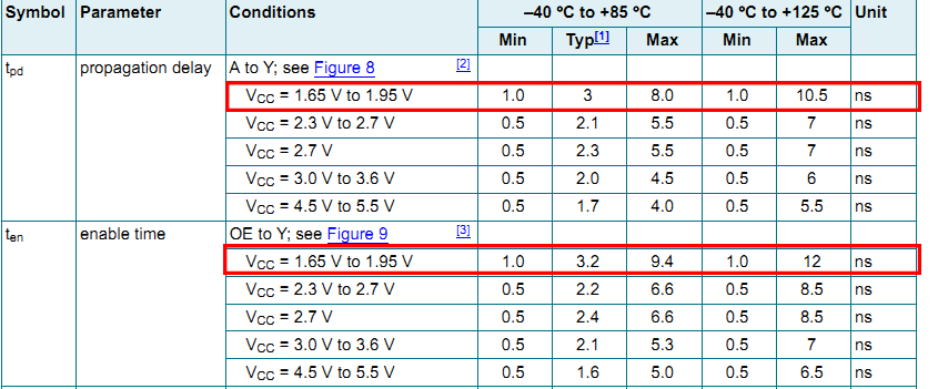

We are using a NXP processor, LPC3250 in one of our products. We are facing few difficulties during production stage.
Problem:  We have designed our product to work over temperature from -40 to +70 deg C. During production, few of the boards are not coming up (getting hung) when powered at negative temperature (between -20 to-40 deg C).  We are booting LPC3250 using a Flash memory and runtime code is accessed from mDDR memory. The part number of Flash is S29GL128S11DHIV20 from Spansion and the part number of mobile-DDR is IS43LR16800F-6BLI from ISSI. We have incorporated all the recommendations in the Errata sheet of LPC3250.  I am attaching a report on the tests done here to debug this issue.

Please suggest any alternate (if any) buffer IC (alternate to 74LVC1G126) which has large propagation time and enable time.

shamanthshetty
Hello Carlos,
We have already tested the hardware without DDR device .No boot issues found in such platform.
Here we didn't removed the DDR device physically from the PCB board instead we  didn't initialize and activate
the DDR device in software. This confirm no issue in our hardware.
As per NXP application note "AN10931"
"To clear the drive condition, the SDRAM device needs a few clocks with the SDRAM
clock enable signal active" and you have proposed workaround solution.Same workaround we have implemented in the design.
My worry here is -the propagation delay and enable time of buffer device(P/N:74LVC1G126)  decides the clock enable time . But it will vary from 1ns to 10ns over temperature and sample to sample causing booting failure
We are stuck at production build due to this major failure in workaround you have proposed. Hope we get good resolution from your end soon.
