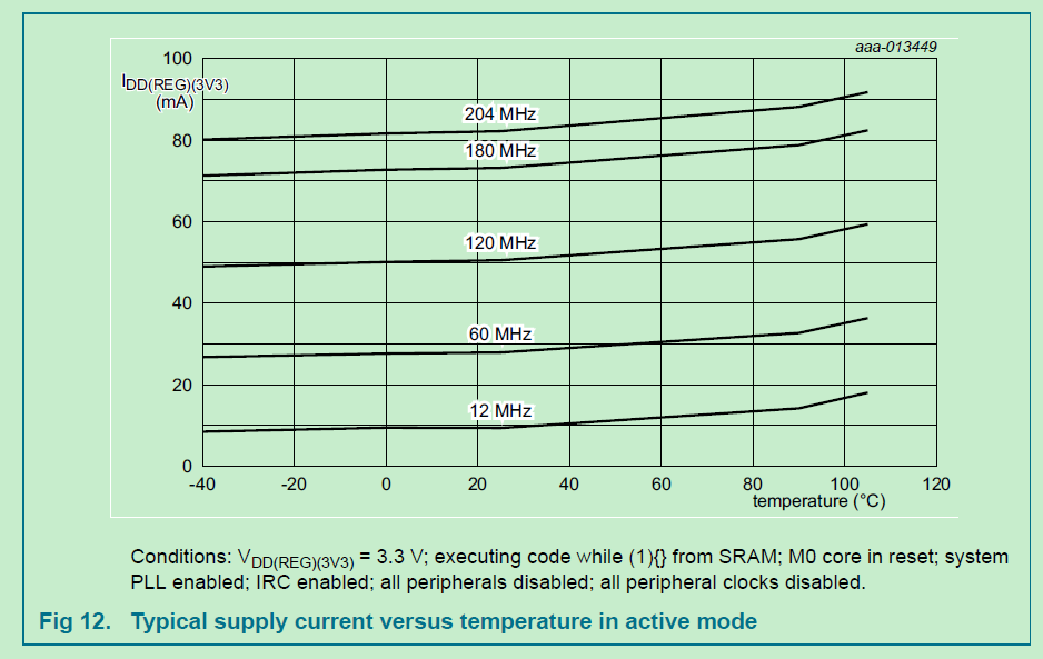

Hui_Ma
Hi Maggie
Unfortunately, we doesn't have the chip core frequency with temperature  coefficient data.
We just provide the power consumption with core frequency and temperature related curve:
Could you provide more detailed data about the chip temperature?
The ambient  temp and the chip surface temp. How about the chip temperature rising ramp?
Thank you.

maggiepan
Hello Mr. Ma hui,
thanks for your reply.
We tested and found it goes normal when the frequency is lowered to 120Mhz, thanks.
