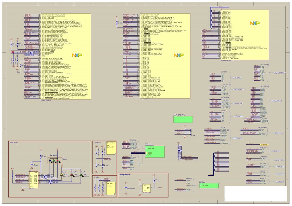

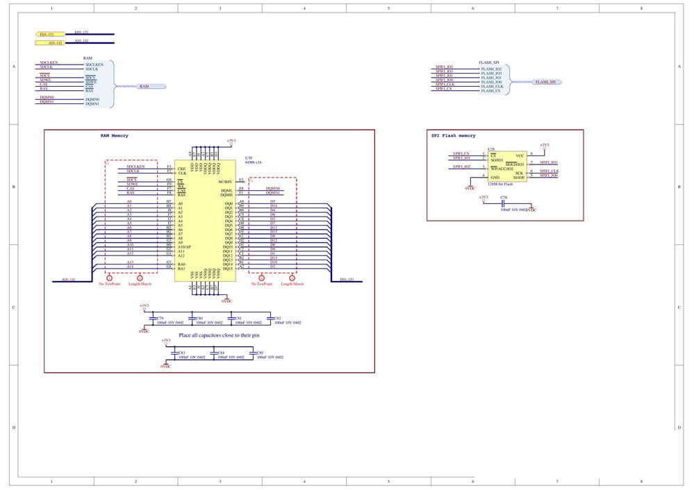

I'm attaching schematic images, too.
Still encoutering thos issues.
Marco

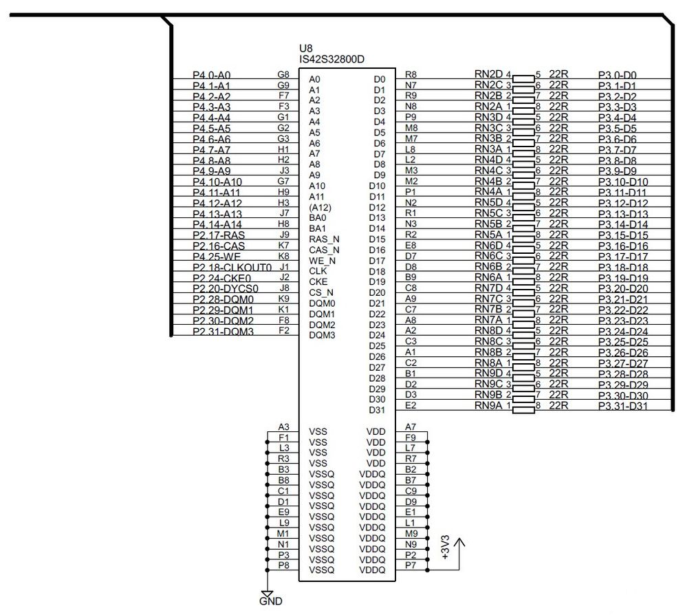

After confirming, the LPC4088 OEM BOARD integrates the SDRAM IS42S32800D whose electrical characteristics are compatible with the IS42S16400J, so I'd highly recommend you to refer to the memtest demo in the lpcopen_2_10_lpcxpresso_ea_devkit_4088.

The demo project you mentioned was the one I startet from. I changed the IS42S32800D parameters accordingly to my memory chip (like some timings, row bank columns, bus width and so on). My code also performs the mem_tests from the demo (walking0, walking1, etc..). So, I had already tried those values.
The only differences I see from schematics are the series resistors in data lines and the fact that I scrambled the data lines to avoid vias in PCB layout.
But, before thinking about 22R series resistors as possible cause, I'm trying to solve the problem by adjusting software.
As last, the data line scrambling should be safe (we have another board with LPC1788, with data lines scrambled and no resistors, that works fine).
The failure in sdram occurs after a while in free running, or as soon as I observe the sdram from "Live Watch". Rarely it doesn't occur at all.
