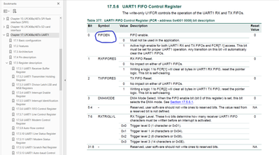

With USART1, how long does the LSR THRE bit take to update after writing to the THR? I ask because the UART is supposed to have a 16-byte deep transmit FIFO, but what I'm seeing is that after writing a single byte to the THR, the LSR THRE bit goes to zero indicating I can't write anymore bytes. There about about a dozen assembly instructions between the point where the THR is written and the LSR THRE bit is (re)examined, so there is plenty of time for the THRE bit to get updated.
The documentation for the UART timing is woefully inadequate. Can anyone shed some light on this matter?
My CCLK is running at 100 MHz, PCLK is at 50 MHz, UART in async mode, 8N1, running at 57600 bits per sec.
Thanks in advance,
KM

Regarding your question, I suppose that you do not enable the FIFO module. If you do not enable the FIFO, after the data has been transmitted via the USART_TX pin completely, the  LSR THRE bit goes to 1, which means you can write another character.
If you  enable the FIFO, after the data has been transmitted to transmitter FIFO, the  LSR THRE bit goes to 1, which means you can write another character.
Pls try to enable FIFO and have a test.
Hope it can help you
XiangJun Rong

Thank you for your prompt reply. I can confirm I enable the FIFOs in our UART init code. Here is the code (pardon the formatting, I didn't have time to wrestle with the email code formatter):

Here is transmit loop from my send data method. I can confirm that only a single byte gets written in the while( wNextByte... ) loop (the buffer being sent contains 4 bytes) and I know that the Tx FIFO is empty at that point because this is the first send data operation.

My UART1 ISR does something similar if the Interrupt ID register reports a INT_ID_THR condition: it loops writing bytes to the THR while the LSR THRE bit is high. Only one byte ever gets written per interrupt though.
Any guidance you can provide would be helpful.
Thank you,
KM
