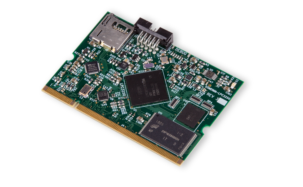

Have you ensured that all the used pins are properly connected and on the correct voltage levels? You could take as reference the schematics, and BSP / Example Software of the 3rd party boards based on LPC3250, like the following:
https://www.embeddedartists.com/products/kits/lpc3250_kit.php
http://www.teamfdi.com/product-details/somdimm-lpc3250
Hope this will be useful for you.
Best regards!
