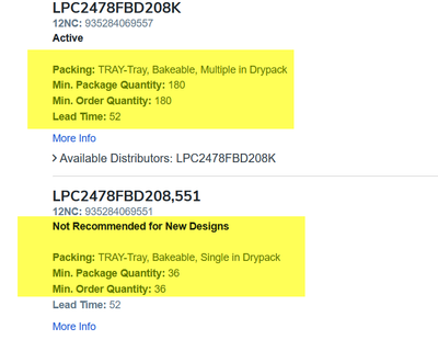

What is the difference between the part in the Subject line and the one with the K added?
I could not see this immediately.
What is the longevity of the K part?

HI Alice
Thanks for the reply. I wonder if you could find more about the K suffix. Maybe it is an internal process change in the manufacturing of the part?
I think your answer is sufficiently substantive though.

Hello plackons,
No change for the chip itself. Just Packing. the name with"K" is the new Packing .
I only can find the information as below:
About deeply information about packing, you can ask distributor, they know this more detail.
Alice

I'm also not sure the difference.
I can confirm the function feature are the same, and the longevity is the same:
