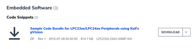

How about refer to demo code how to config:
https://www.nxp.com/products/processors-and-microcontrollers/arm-microcontrollers/general-purpose-mc...
Alice
