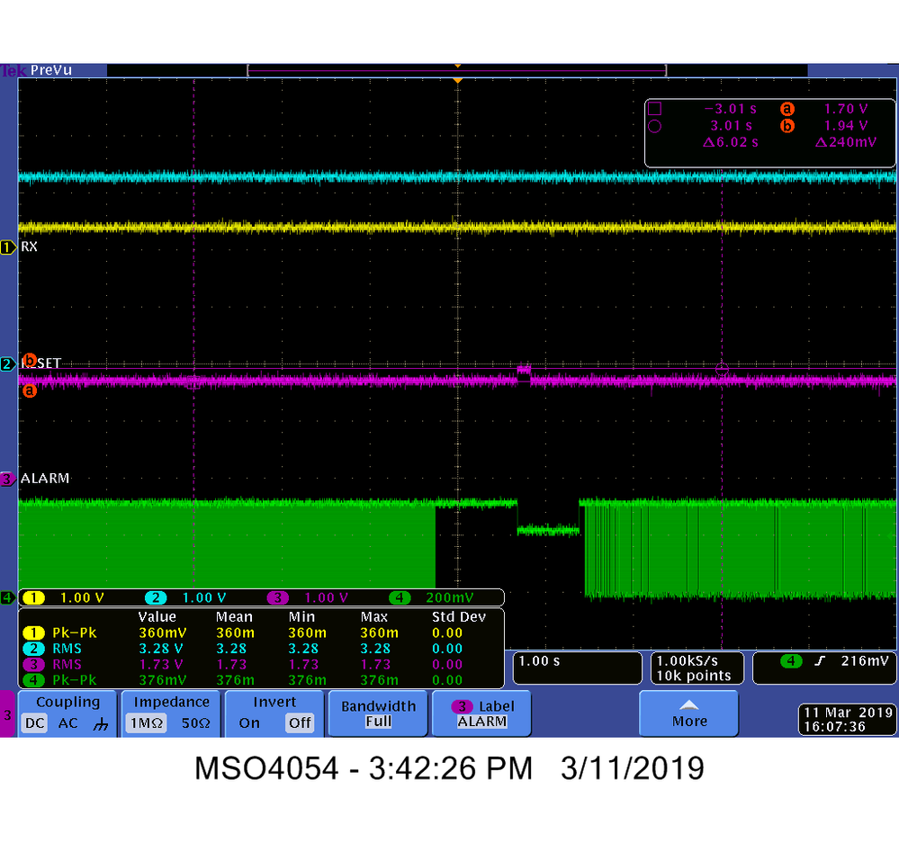

soren_schuler
Hello Bernhard
Here is the sequency i have observed.
Chamber Temp set 95 degC
Adjacent board temp report 102 degC
I chose to use following pins for observation
RS232 data stream Tx (from MCU)
ALARM pin
RSTOUT pin
1) ALARM out pin
 -intial value was 1.74 V (not 0 V as expected)
 -Pulse from 1.74 V to 1.82 V for 148ms
 -ALARM went to 0 V after pulse and never went active again
2) Firmware reported STACK CHECK failed
3) TX data stream stopped.
4) send Reset to MCU pin 24
5) not action observed.
6) Power cycled
7) TX data stream started up again
8) After a while it stopped again
9) I repeated 7 multiple times
9,142 Views
bernhardfink
The LPC2378 should also work on higher temperature, but you might need to recude the operating frequency. At higher temperature you normally increase the chance to run into race conditions on the digital blocks. The edges of the signals are less steep due to increased parasitic effects, so the rise and fall times are longer. Especially the connections to the outside, for example to the SDRAM, are affected from this. You can fix this problem most of the time by reducing the operating frequency, increase number of waits states on flash, reduce SPI frequency etc.
On the analog blocks like A/D converter, PLLs etc you may see malfunctions as well, no way to fix this.
Our spec specifies 85°C as max operating temperature, this is not the ambient temperature but the silicon die temperature Tj. If you operate the die on higher temperature it will not be damaged, but the lifetime decreases as the silicon is under increased stress.
Bernhard.
9,142 Views
