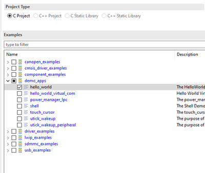

There is no need to figure everything out for yourself.
Although I have no LPC11xx MCU or board, so I use the one available to me as example.
First, create/download a SDK for your MCU and host OS. This process is well documented, I think.
Then, load this SDK with MCUXpresso, AFAIK by just dropping the file into the IDE Quickstart window.
Then, import an example from said SDK, as seen here :
For the SDK I used, there is a "Hello World" in the demo_apps, as seen here:
It should compile and build fine.
If you have a SDK for a specific board, it should run without any additional work or modification.
And I would start from there with modifications.

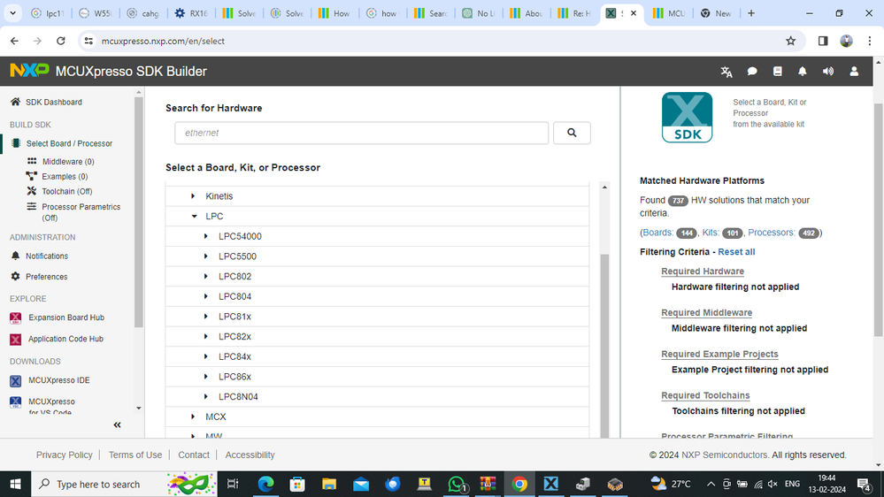

kamalesh
Hello Frank,
I tried this SDK creation. But This microcontroller series itself is not there. I uploaded a picture for your reference.

frank_m
Senior Contributor III
Now that you say it ...
I didn't realize that the LPC11xx family is already so "old", and not directly supported by the SDK generator. But I had similiar experiences with LPC14xx and LPC17xx devices.
I would follow the recommendations of poster Ricardo_Zamora, and try the links to LPCOpen libraries and examples.
But if you deal with a project here that can be considered "commercial" in any way, I would rethink my choice of MCU. In my experience, it usually doesn't take long from fading toolchain support until the EOL notice is disseminated.
For hobbyist projects this is less of an issue, though.

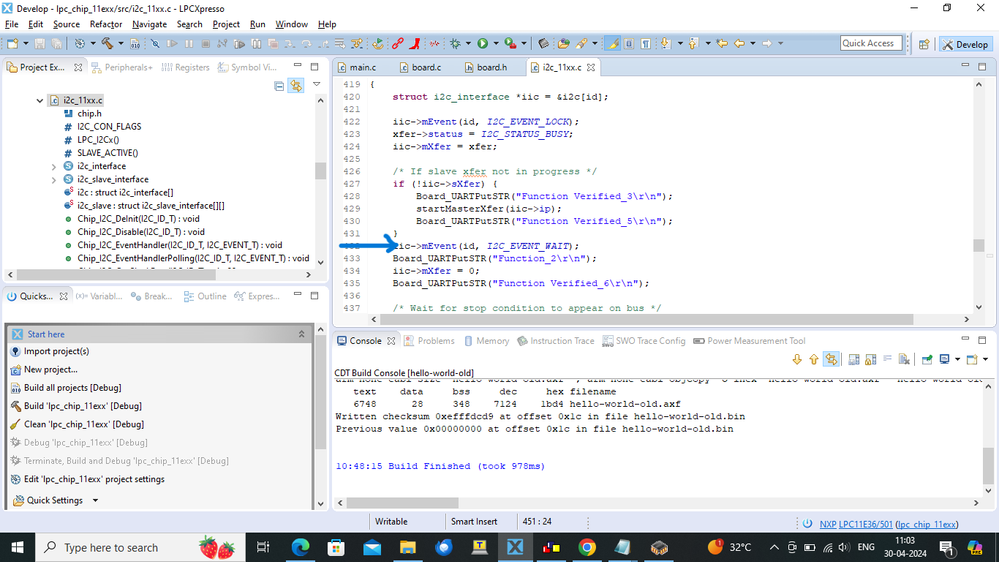

kamalesh
Hello Ricardo_zamora and Frank,
Sorry for the late reply.
I successfully achieved the hello world program through uart in lpc11e36 microcontroller.
Now, We are one step forwarded. I am trying to do the lcd program. My lcd is connected with i2c expander of PCA9546AD(channel -1). I2c from lpc11e36 microcontroller connected with this i2c expander.
I written one program to send hello world string to this lcd from this microcontroller. I attached the code given below. After executing the program, it is stucked. I found the place also. But I dont know why it is stopped in this place. Screenshot (14).png
During the execution time of this line Chip_I2C_MasterSend(I2C0, I2C_LCD_ADDRESS, data, 2);,it could not processing this line.
In this above picture, I marked the line which I got a struck. Could you please clarify my doubts and verify my uploaded program?

frank_m
Not having a LPC11e63 board or LCD display / I2C expander, I cannot say much about this issue.
But I would attach a logic analyser (or scope) to the I2C lines, and check the actual bus signals against the expected (i.e. the datasheet of the display/expander).
I would suspect the event this code waits for is an ACK from the slave.
Perhaps the I2C address is not correct.

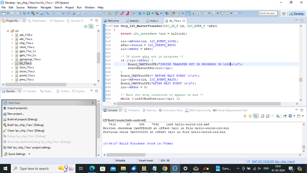

kamalesh
Hello frank,
Actually I tried your suggested way physical address also, but based on my program structure, it is strucked on CHIP_I2CTRANSFER function only.
I tried another example which is test the i2c communication of our board. In this program, I written some data in EEPROM of one address. For this write operation, I used this chip_i2c_transfer function. after this write operation, i have to use the read operation to read the data from the same address whichever I written in EEPROM. After Executing the transfer function in this i2c, It is stucked on i2c_event_wait. I uploaded a photo given below.
Also I found some forum related to my problem. I given the link below. They gave some software fix. How about my case?
https://community.nxp.com/t5/LPC-Microcontrollers/LPC4367-I2C-stuck-in-interrupt-handler/m-p/827339
Till this printing of BEFORE_WAIT_EVENT is happening, after this not happening. I want to know what is the reason.
Here, I only given a random address and doing those operations(read and write).
Is there any issue in my i2c communication?
Could you please tell me, why it is happening here?
For your reference, I attached my recent tested file.

frank_m
To be honest, I don't know if this issue is related to your case.
This is a different MCU, and the I2C peripheral might be a different IP, with a different register interface.
I would start with consulting the I2C bus specification, and then try to monitor/record the actual bus signals in your case.
Many I2C slave devices, especially more complex ones like an LCD interface, define special requirements (usually for multi-byte transfers). You would need to compare the code and the observed signal with the requirements of your slave device.
I2C code for an IO expander or an EEPROM will not directly work with e.g. an I2C ADC or LCD device, you need to modify it.
