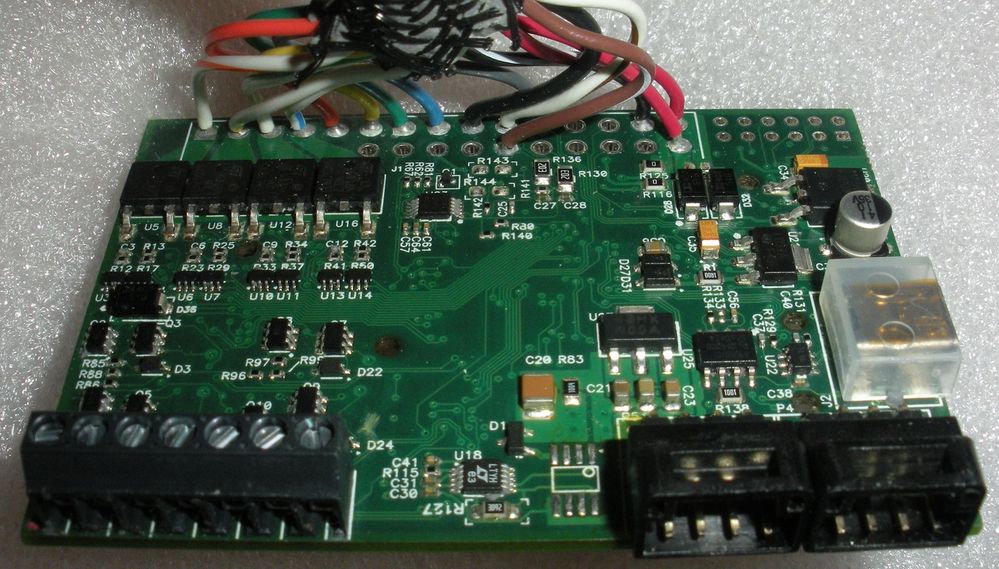

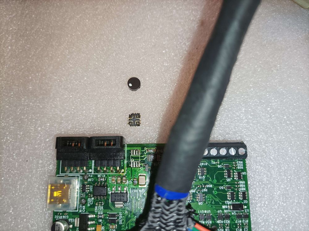

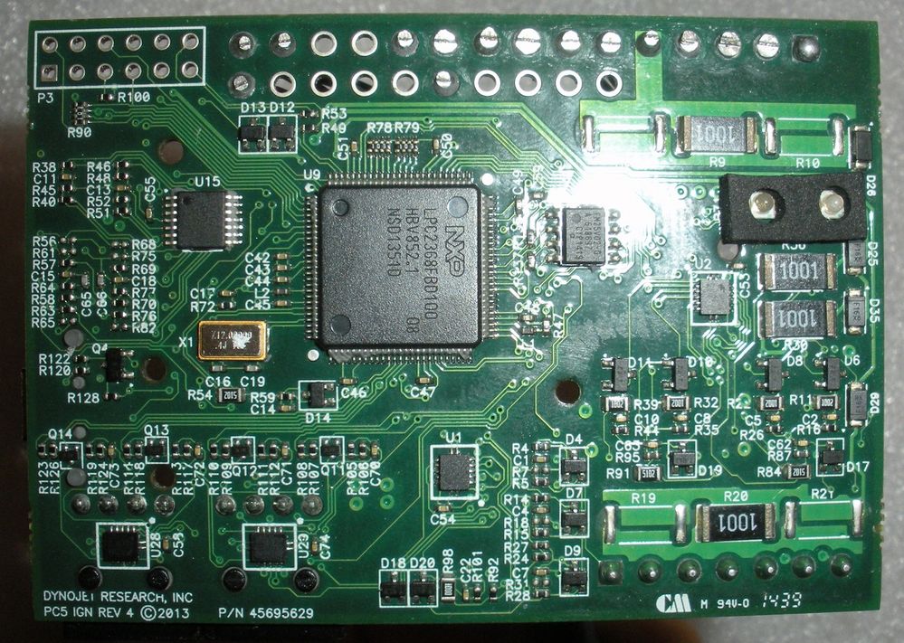

Im looking for an advice or help for fixing/repairing my Power Commander 5 device which is based on NXP LPC2368FBD0100 chip.
The circuit board has one 8pin power inductor lost from it's component place T1, and im trying to find a new component which would be compatible with the layout.
A picture of a loose off broken, and removed component
https://www.dropbox.com/scl/fi/w50ytdkmypo6hsbj7ga0k/IMG_20250316_173517.jpg?rlkey=m5ftfwrfr6lunq2zi...
Here's pictures from both sides of the device;
https://www.dropbox.com/scl/fi/oh8xru8tevd214k1v3hkp/Alta.png?rlkey=sm7pq2m8y0brzfljd87w3ffhk&st=oc6...
https://www.dropbox.com/scl/fi/oiawc1yptxe16mahjxkhh/P-lt.png?rlkey=3q3f0x1b5s3rxjsvyymsfybb8&st=9io...

According to new infromation about the device, it's actually a model B22-018I instead of 22-049. Not sure why there's a serial number/device model -sticker of the device on the packakge as S/N & 22-049, while the program reads out directly from the device the same S/N, but recognizes the device as B22-018I which is alot older model I suppose. Not sure if DynoJet was aware about that but the information has a meaning while I have to seek a spare part for the circuit board. I haven't found yet.

I got some measures for the power converter, power inductor.
1st coil measure counts from 0,002mH to 0,000mH while resistance counts from 000,6 - 000,2ohm.
2nd coil gives more stable 1,061mH and resistance 12,1ohm

Some USB microscope pictures revealed that coil between the pin 1 & 4 has four wire coil and pins 5 & 8 has a single wire coil. I had a long chat with OpeGPT about it and it offered nice information of many solutions but none presice yet. The wire of coils are wery thin indeed.

If I only knew what type of power inductor/transformer/inverter component that T1 is. Speqs/datasheet would be super. As development I would rather use this shape of component; https://in.element14.com/bourns/srr0906-562yl/inductor-5-6mh-15-0-09a-smd/dp/2333787

Thank you, I allready found a datasheet about the main chip LPC2368FBD0100. I'll see it while seeking the component to make the device work properly again with the chip. At the moment after few hour overall seek I haven't found even same shape spare part for the device. The component has a meaning since the chip wouldn't possibly work properly if the layout is missing a function related component. So im worried about the safety of the chip.
