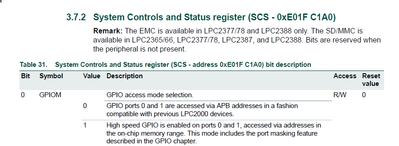

2. For GPIO application, we configured Port 2(0 to 7) as output and set as high. measure the output voltage. we are getting only 2.3v. Is it correct ?(output should be only 3.3v ?)
3.For GPIO application, we configured Port 2(0 to 7) as output and set as low. measure the output voltage. we are getting 2.3v ?
>>>>You can follow up the procedure to set the GPIO pin in output mode:
1)set up the GPIOM bit so that you can select the legacy mode or high speed mode.
SCS&=~(0x01); //flor example useing legacy mode, clear the GPIOM bit
2)set the corresponding bit in IODIR
IO0DIR|=0xff; //the the GPIO0_0~GPIO0_7 are in output mode
3)set the GPIO0_0~7
IO0_SET=0xFF
4)clear GPIO0_0~7
IO0_CLR=0xFF;
Pls have a try
