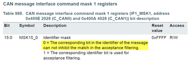

Set  the CAN message interface command mask registers to 0:
7,734 Views
Dim724
Alice,
Good advise, thank you! So we have initialized MSK1 and MSK2 with 0 values and we have our single Rx ID set to 0x1FFFFFF for both CAN0 and CAN1 controllers. In theory both controllers now must accept any frames within 0x0000001 to 0x1FFFFFF range. It works, so at this point we're getting close to our final goal. Now we have another issue while transferring data between CAN0 and CAN1. As we're working on a gateway, we're simple trying to receive a message from CAN0 channel and transmit it from CAN1 channel like this (inside the CAN0 IRQ
