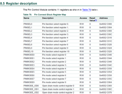

Hello, I am new to LPC Microcontrollers and I want to write '1' to a particular Pin on LPC1768 that performs the function of SCK(Serial Clock). My question is, Do I need to always use PINSEL to select the pin before I use FIODIR and set the Pin. Also what are difference between the statements below: LPC_PINCON->FIODIR |= (1<<15); LPC_GPIO0->FIODIR |= (1<<15); LPC_GPIO0->FIODIR |= ((1<<15) | (1<<16)); LPC_GPIO2->FIODIR &= ~((1<<15) | (1<<16)); Thank you.

I think the line LPC_PINCON->FIODIR |= (1<<15); is incorrect.
The line LPC_GPIO0->FIODIR |= (1<<15); is correct, in other words, the FIODIR  register is only belongs to GPIO module rather than IOCON.
For IOCON module, pls use the PINSEL[reg] to select the pin function.
void Chip_IOCON_PinMuxSet(LPC_IOCON_T *pIOCON, uint8_t port, uint8_t pin, uint32_t modefunc)
Chip_IOCON_PinMux(pIOCON, port, pin,
/* mode is in bits 3:2 */
modefunc >> 2,
/* func is in bits 1:0 */
modefunc & 3 );

Pin mux block:
Hope it can help you
