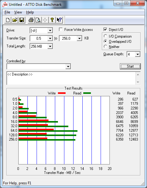

bernhardfink
Hi Tyler,
the numbers you achieve are quite OK, not much you can do to improve it.
This is our USB-2-SD card test result with 51MHz SDIO clock:
The SDIO interface itself with specific cards could achieve higher rates (9 Mib/s write, 18 Mib/s read), but in combination with the USB we have achieved (only) the numbers above.
Bernhard.
