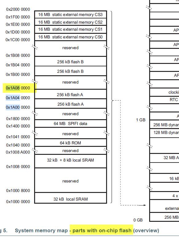

I have a question about flashiap.c
/* Start signature address of the last sector*/
#define START_ADDR_LAST_SECTOR 0x1A070000
Why does the last sector is 0x1A070000, how to calculate this address?
In my understanding, flash base is 0x14000000, I don't know hwy the sector 14 is 0x1A070000
Please teach me.
Ken

Hello kensu,
This address is for LPC18xx with on-chip flash, for LPC1830, this space is reserved.
For on-chip flash, yes, the start address of last sector is 0x10A70000:

Hello Alice
I understood now.
Thanks for your reply.
