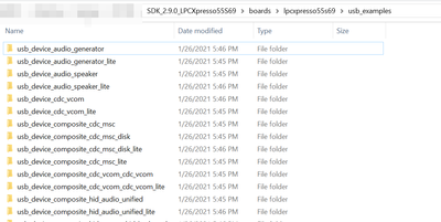

i just downloaded the new SDK update 2.9 and i'm currently use MCUXpresso IDE 11.3 with my board LPCXpresso55s69
Is that normal that many examples are not avaiable anymore? I'm looking for the USB ones and i cant find them when i go to "Import SDK example(s)". Also, i think that some USB files that can be found in the "importing SDK components" of a project are missing.
Surprisingly examples and files are avaiable when i download a SDK archive for Keil.
is there something i can do to add them?
Thank you.

Please go to web site
https://mcuxpresso.nxp.com/en/welcome
to download LPCXpresso55s69 SDK package. Make sure you select USB component before download. I have tested it, USB samples are there.
Have a nice day,
Jun Zhang
