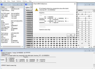

andarm
- MCU: LPC 1830
- method : JTAG
- Error:  can connect successfully , then erase and download error.
- Hardware:  device running ok before. I just test it again, then I saw the problem.

OK, the Segger support also suggest to use latest J-link software:
Could you please retry with the latest version of J-Link software package?
https://www.segger.com/downloads/jlink/#J-LinkSoftwareAndDocumentationPack

andarm
Thank you very much . I found it can work in JFlashV4.92.  I think that   segger's software compatiable issue.
