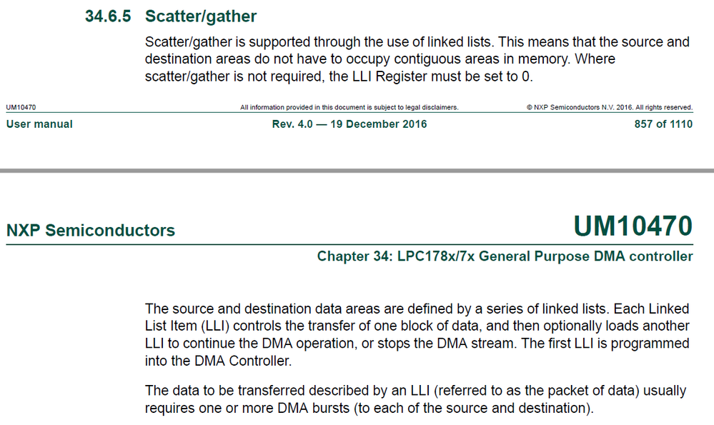

I'm trying to use GPDMA M2M transfers using an external SDRAM memory connected to an LPC1788. The idea behind this is to automate copy of data between 2 different buffers (front buffer and back buffer), in a video application.  There must be transferred 768000 bytes from one buffer to the other every time the apllication does the "buffer switching". Has anyone did it already? Is it possible? Could anyone post an example on how to configure the hardware? Should I use linked lists to enable transfers of more data?

According to your statement, it seems that you want to implement the scatter/gather feature of the GPDMA, is it right?

I'm really not sure about the need of the scatter/gather feature. I have 2
memory areas, each one with 768,000 bytes. The 768,000 bytes in each area
are contiguous. Both areas reside in external SDRAM, and I would like to
use the GPDMA with M2M configuration to copy data from one area to the
other. So, the GPDMA needs to transfer 768,000 bytes each time. On each
pair of transfers, in the first one buffer A need to be the source and
buffer B need to be the destination. In the second one buffer A is the
destination and buffer B is the source.
Thank you very much!!

In my opinion, you can give a try to use the scatter/gather feature to make it.
