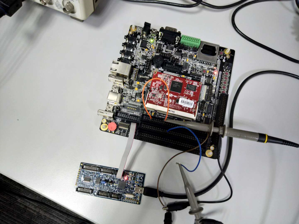

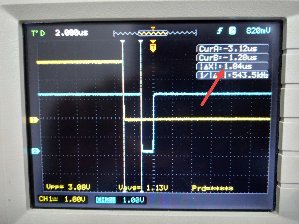

Hi James Kent ,
Thanks for your reply.
I'd like to run the periph_timer demo which is from the LPCOpen library to replicate the phenomenon you mentioned, the P0.21 outputs the 1.2 KHz PWM, then connect the PWM to the P2.10, it will trigger an interrupt when detecting the falling edge, and in the GPIO interrupt function, it toggles the P0.22.
After running the demo on the LPC1788 Eva board, I find that the delay is about 1.8 us which much smaller than 650 us, and I think it still can decrease with some tricks.
I've attached my testing code, please check it.

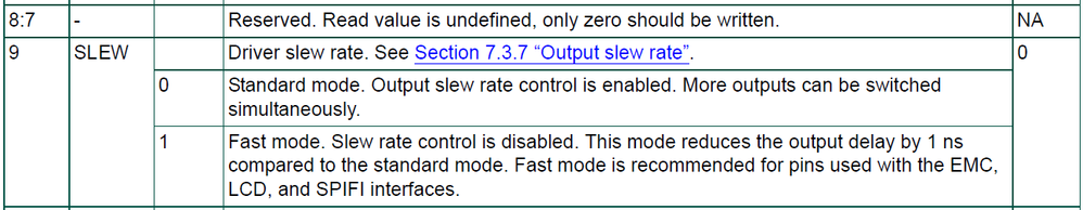

jeremyzhou
Hi James Kent ,
for the opportunity to serve you.
According to your statement, the 'delay' you mentioned is the interval between the input clock and GPIO pulse which is triggered in the interrupt function, is it right?
If yes, I'd like to suggest you set the SLEW bit in the corresponding IOCON register, it can reduce the output delay.
Hope it helps.
