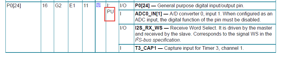

P0 [24] to P0 [28] of LPC 1778,
P2 [8] P2 [9] P2 [11] to P2 [13],
I want to set PULL-UP for P5 [1] to P5 [3]. . .
P0 [26], P2 [8], P2 [9], P5 [1] are OK.
Others are NG.

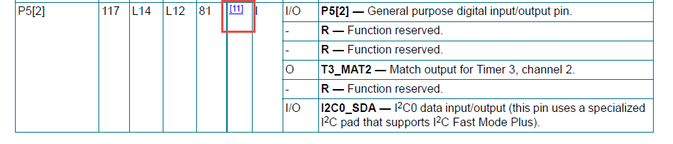

If an external resistor (10 KΩ) is connected to P5 [2], P5 [3]
It is confirmed that the operation is OK.
If possible, GOOD is better without external resistance.

 1. P5[2] and p5[3] is the open drain 5V tolerant pin, it needs an external pull up to provide output functionality, you can find it from the datasheet.
2. P0[27], P0[28] is also the open drain pin.
3. But, P0[24], P0[25], P2[11],P2[12],P2[13] and P5[1] in default, it enables the PU,
But it is the input function in default, you need to configure it to output by yourselves.These pin's Pull up is OK, please double check it.
