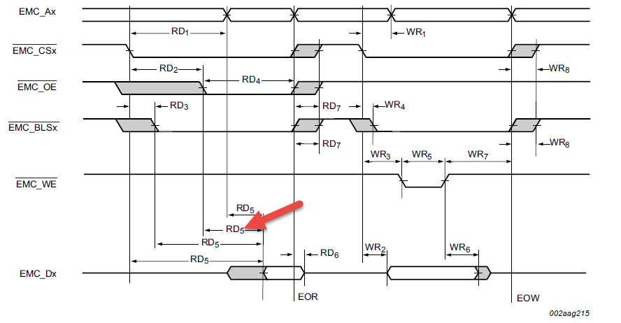

When using LPC1778 with 32-bit External Memory interface,
(refer to cmsis-RTOS)
CS / OE selection interval is set to 60ns, but the actual operation is doubled with 100ns.
CS & OE ENABLE Interval timing is 2times longer than Address & Data.
How to reduce these CS & OE ENABLE interval timing such as Address/Data interval length?
(CS : Green, OE : Yellow, Addr : violet, DATA : Blue)
in order to operate same interval length exactly between CS/OE and Address/Data.
It's occurred address changing(0 ->1 : Blue circle) due to 2-times longer interval length.
How to change such as RED line in drawing signal waveform attached?
1. Issues :
1)     CS3 setting value is set to operate at about 60ns as shown below, but 100ns actually appears
2)     ADDR changes while maintaining CS3 LOW (CS is changed once after 60ns in 120ns interval)
3)    When CS3 is output as 120ns, it is outputted as 60ns every 16th.

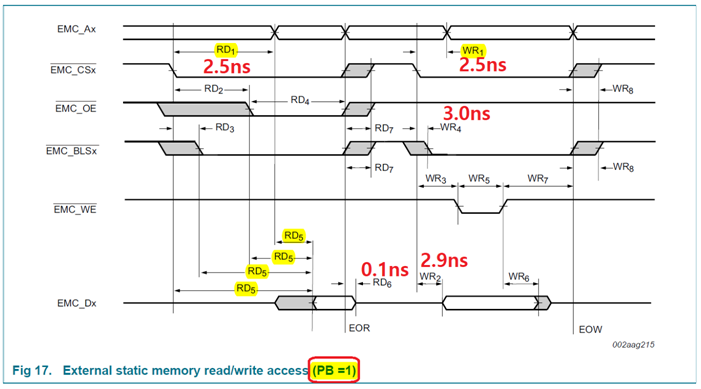

CS related setting value
* PB = 1
Set. value
Tcy(clk)
60MHz
16.7ns
WAITEN
0
WAITWR
5
WAITOEN
0
WAITRD
2
WAITPAGE
2
WAITRETURN
1
Cal. vaule
RD2
2.5ns
RD4
48.4ns
RD5
34.5ns
3. look at the Timing diagram as below, there are four RD5s,
     Which is the standard? or What is the standard?

1. The Interval timing between CS and OE_ENABLE is RD2, do you mean that this timing value becomes the 100 ns, not the 60ns as the expected? If yes, I don't find this issue exists in the figure.
So I was wondering if you can attach the figure which contains more wave, it can illustrate the issue more clearly.
2. From the top to below, The second RD5 is standard.

1. I mean that CS (or OE) Low active selection interval length is set to 60ns, but the CS or OE actual Low active length is 100ns, that means double length against I want to set 60ns.
You can see the above attached waveform's Delta 61.6ns timing vertical Line from (a) to (b).

jeremyzhou
Hi eric kim,
In your original question, you said 'CS / OE selection interval is set to 60ns, but the actual operation is doubled with 100ns', Fig 17 illustrates one read cycle and one write cycle.
However, in the continual read process, the CS and OE will keep low, so this phenomenon is normal.
After reviewing the attachment, I find that MW=1(16 bit), but you actual use the 32 bit as SCH shows.
If a memory bank is configured to be 32 bits wide, address lines A0 and A1 can be used
as non-address lines. If a memory bank is configured to 16 bits wide, A0 is not required.
However, 8 bit wide memory banks do require all address lines down to A0. Configuring
the A1 and/or A0 lines to provide address or non-address function is accomplished using
the IOCON registers.
Another problem is PB bit should be asserted 0.
Regarding to your implementation, I'd highly recommend you to refer to a parallel-Nor flash's datasheet if you want to use the FPGA to simulate it, for instance, SST38VF6401.
