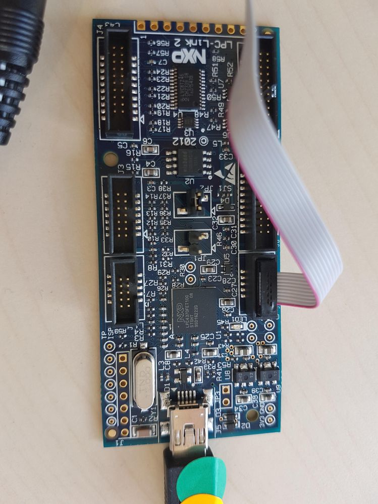

trong-nghiachen
Software version: MCUXpresso IDE v10.0.2
Sample: NfcrdlibEx1_BasicDiscoveryLoop

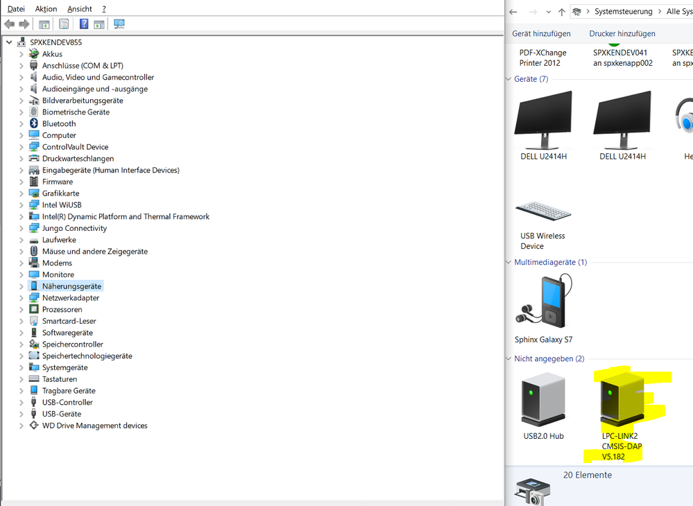

Drivers: installed, see picture

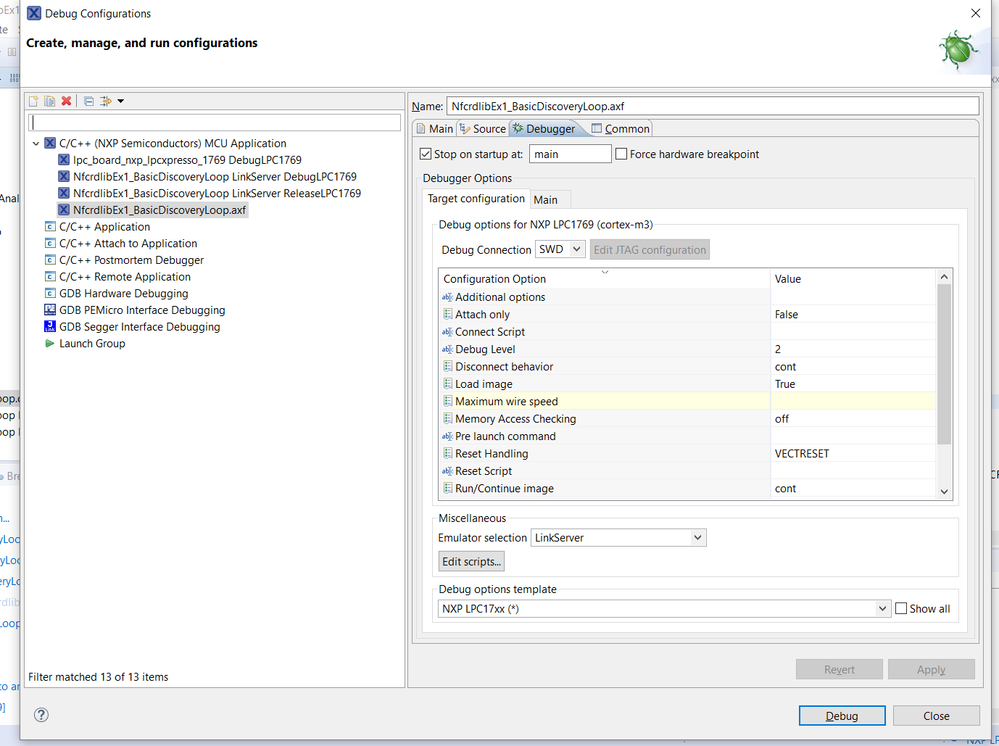

Debug Setting:

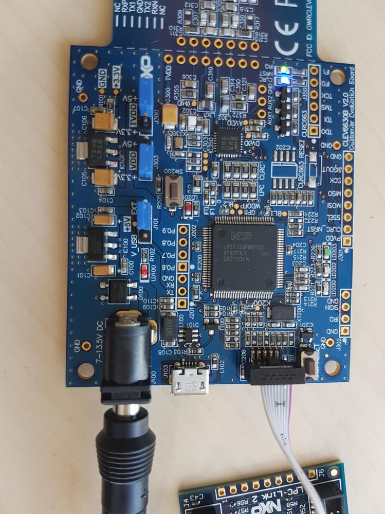

power: power supply 5v 1000mah

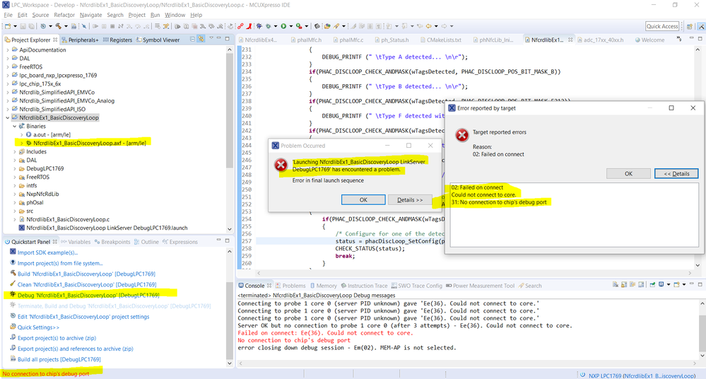

But, if I try to start debug-mode, I get the error-response.
But try a lot of setting and different usb port and jumper-setting, but the error stay the same.
LPC1769 works standalone with "nxp cockpit"
Does someone have an idee?

I did reinstall IDE and restart the PC, I could build the projects again, but I got the same Error as yesterday
MCUXpresso RedlinkMulti Driver v10.0 (Jun 22 2017 23:31:55 - crt_emu_cm_redlink build 272)
Reconnected to existing redlink server (PID 4294967295)
Connecting to probe 1 core 0 (server PID unknown) gave 'Ee(36). Could not connect to core.'
Server OK but no connection to probe 1 core 0 (after 3 attempts) - Ee(36). Could not connect to core.
Failed on connect: Ee(36). Could not connect to core.
No connection to chip's debug port
error closing down debug session - Em(02). MEM-AP is not selected.

I found the problem.
The cable was connected in wrong direction ...
