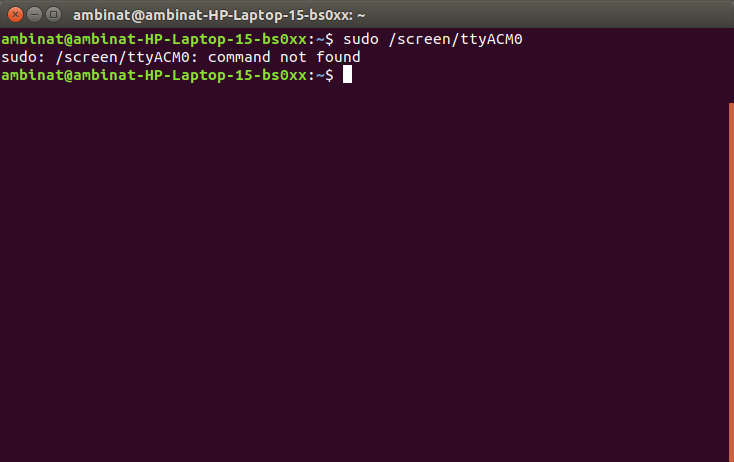

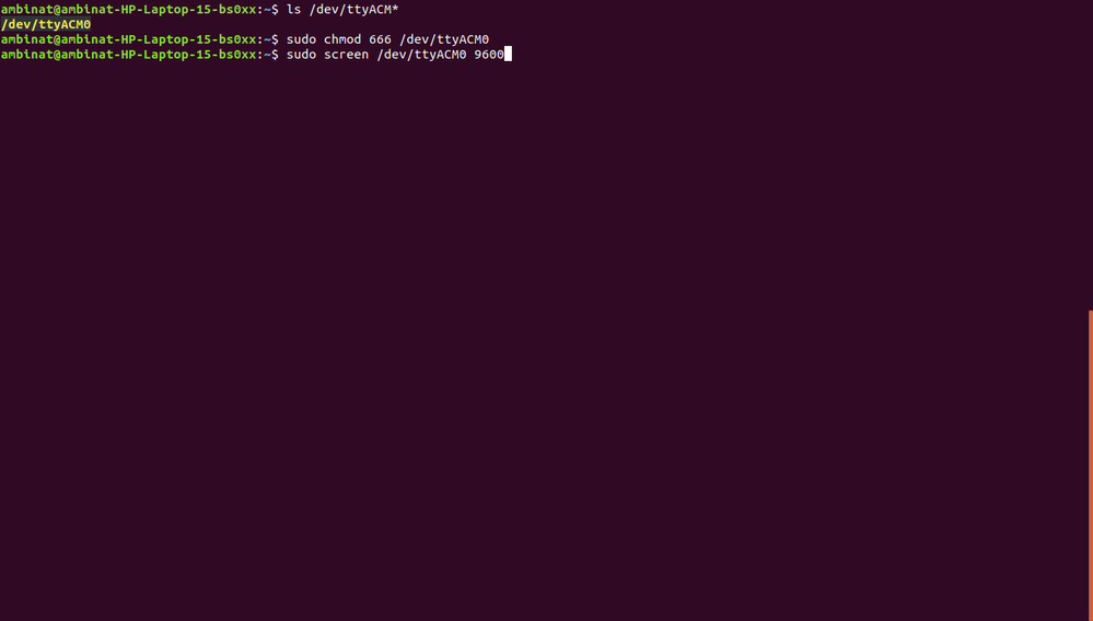

We are using the usbd_lib_cdc_uart code in debug mode on the OM13085 board. We are trying to get it to communicate with a serial terminal program called screen.
The device works perfectly fine on an Apple MAC:
It also shows up on the ls command and we have given the OS permission to access the serial port as well:

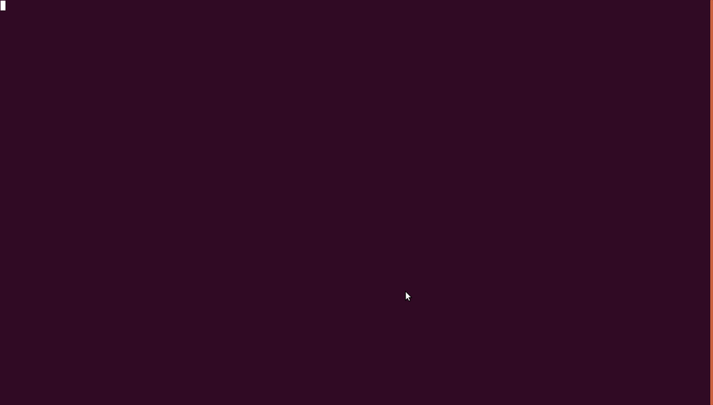

However, when we try to access the device using screen we don't get any output:
We also tried using /screen/ttyACM0 command but that also did not work:
We tried Putty terminal as well but somehow putty cannot connect to the device either.
Please advice if we are missing something.

converse
Senior Contributor V
Make sure you are connecting the the correct device (/dev/ttyACM...). There could be more than one device with a similar name. Too check:
Disconnect your device
ls /dev/ttyACM*
connect your device and load and start your code
ls /dev/ttyACM*
and look to see which new device(s) have appeared.

ND2
If you notice the output of the ‘dmesg’ command you will see there is only one device on ACM which is the ACM0.
So there is no question of connecting to a different device.
