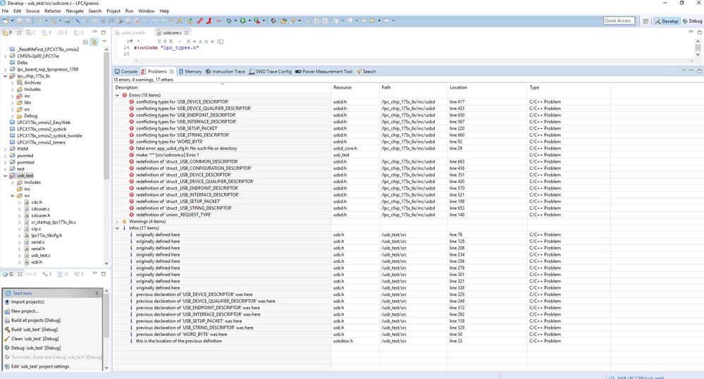

I use the LPC1769 to communicate over a usb as a virtual com port.
I dowload the CMSIS libary from:
lpc17xx.cmsis.driver.library/Examples/USBDEV/USBCDC at master · scottellis/lpc17xx.cmsis.driver.libr...
I get some include erros: I include the lpc_chip_175x_6x libary
Then I get: fatal error: usbd.h: No such file or directory    usbcore.c    /usb_test/src    line 32    C/C++ Problem
I include the usbd folder from the lpc_chip. After I get a lot of conflict type erros (see the sceenshot below)
I seems there is a conflict between usb.h and usbd.h. I didn't understand this.

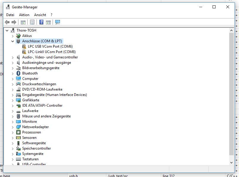

Also I try to install the driver for the virtual com port: But the driver cannot used for my x64 based system. I fond a driver in windows 10, but there is an error (see the sceenshot below). Can I used this driver from windows 10.
I hope somebody can help me.

Hi Thore,
I would highly recommended you to use the LPCOpen packages for development work instead of the CMSIS code packages, you can download the latest LPCOpen package from this page:
LPCOpen Software for LPC17XX|NXP
You could use the usbd_lib_cdc or usbd_lib_cdc_uart projects as base for your application.
Hope it helps!

Hi Carlos,
Thank you. The usb_lib_cdc project works.
