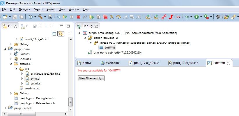

I´m working with LPCXpresso v8.2.0 [Build 647] [2016-07-18] on LPC1769 & LPCOpen 2.10 (http://cache.nxp.com/files/microcontrollers/software/LPCWare/lpcopen_2_10_lpcxpresso_nxp_lpcxpresso_...) Powe Mode Use application (periph_pmu.zip) have a problem.
In debug mode when I press Resume (F8) the Sleep mode works OK, but the other three modes (Deep-Sleep, Power-down and Deep-Power-down) don´t work OK => debugging is stopped (see image or attached file).

Hi Hi Juan Manuel Cruz,
Thanks for your reply.
In the reference manual, it also recommend the user to re-configure the PLLs and clock dividers after the wake-up.
So it good to call the Chip_SetupXtalClocking() to re-configure the PLLs and clock dividers after the wake-up.
And I'll report the issue to the AE for checking.
It's not an issue.

Thanks jeremyzhou, the debugger does not work in those low-power modes.
But the LPCOpen library has a bug and to fix it => set the microcontroller clock & PLL calling the function Chip_SetupXtalClocking() after WFI or WFE.
I was wondering if you can clarify where the "bug" reside in.
Thank you in advance.
Ping
4,875 Views
juanmanuelcruz
This application uses a UART of microcontroller to send debug messages, when the CPU returns from the low power modes it is necessary set the microcontroller clock & PLL so that the UART operates correctly again and that we can see OK the UART messages.
Set the microcontroller clock & PLL calling the function Chip_SetupXtalClocking() after WFI or WFE.
We can do this call in the LPCOpen library or in the application, but we must do it for the example to work correctly, OK?
