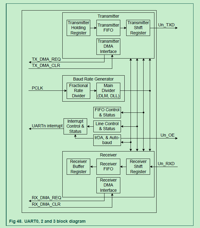

However, I experiment some collisions in the received data frame, and RX data are loss.
Looking into LPC user manual, I notice that both registers for RX and TX (respectively named U3RBR and U3THR) are pointing on the same address?
Is this possible, in such conditions to get UART working in full duplex ?
Any clue ?
Thank's
René
2,845 Views
kerryzhou
Hello customer,
     Although the RX and TX are pointing on the same address, but I think it actually is the separated register. You can check the diagram.
Read return the contents of read only received data buffer, and write go to the write-only transmit data buffer.

If you didn't enable the transmit interrupt, you can just handle the receive interrupt.
Please test the receive interrupt directly, whether you also have the receive problem?
If you still have problem, please let me know!
Kerry
2,845 Views
rnb
Thank's Kerry,
This solve the problem. Now transmitting and receiving using IRQ.
