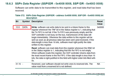

Why is it that after opening DMACR in SSP0 and transmitting some data to BUF, DMACR is reset to zero, SSP0DR keeps changing, but BUF data remains unchanged.I also tried to reopen DMACR during the interrupt, but there was still no change in the BUF data.

Harry_Zhang
Hi @Lee_Lee
I think DMA is' reading empty SSP FIFO ', but due to an incorrect access width, data has not been written correctly into memory.
What are you currently configuring
(0x00<<18)//源数据宽度
(0x00<<21)//目的数据宽度
But in LPC:
The DR register of SSP is a 16 bit register
Even if you are using 8-bit SPI mode, DMA access to SSP0->DR must still be 16 bit access.
DMA did not actually write data correctly into memory
The result is that BUF remains unchanged.
So i think you can try to change the source and des width to 16.
Harry
