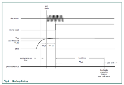

ZhangJennie
Here is the startup timing for LPC15xx. You can also find it in UM10763, 3.7.2 Start-up behavior
unfortunately, we don't have similar AN of AN11027 for low power wakeup time. User needs to refer AN11027 or AN10915 to measure it by self.

ravipatil
Hi Zhang,
Thanks for the reply, I think u are referring to UM10736 not UM10763.
According to this document it takes around 255us to start running MCU user code.
Just want to Know whether the wake up timings in the sleep, power down, deep power down modes are closer to LPC11xx MCU's?
