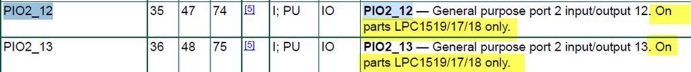

Hello ceri,
"USB connection, P2-12, P2-13"
LPC1549 doesn't have the two pins:
Alice
14,759件の閲覧回数
ceri
In the data sheet for LPC1549,
it states pins 35, 36 are USB only.  ??

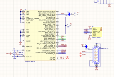

Pin 35/36 is indeed USB pins (only) on the QFP48, I use this:

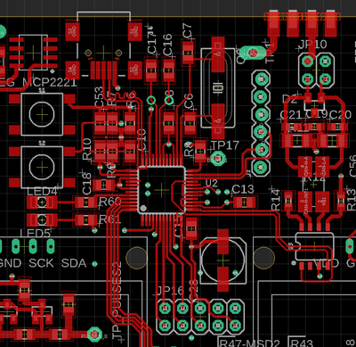

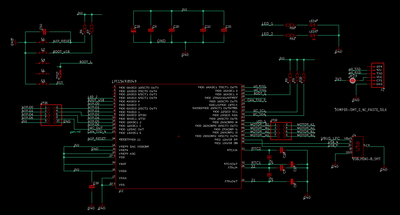

ceri
This is my version:
And the copper:
with CAN circuitry as well,
There is a 100R resistor in C16 slot, pulling RTX-IN low (as in data sheet, if not used)
I am still not able to get USB IAP to work.
I notice though  two things, on your schematic:
Boot 0 and Boot 1 connected, which I believe means you can only go into serial boot (I need USB Programming)
and those are not the CAN pins for 48 pin device ?
